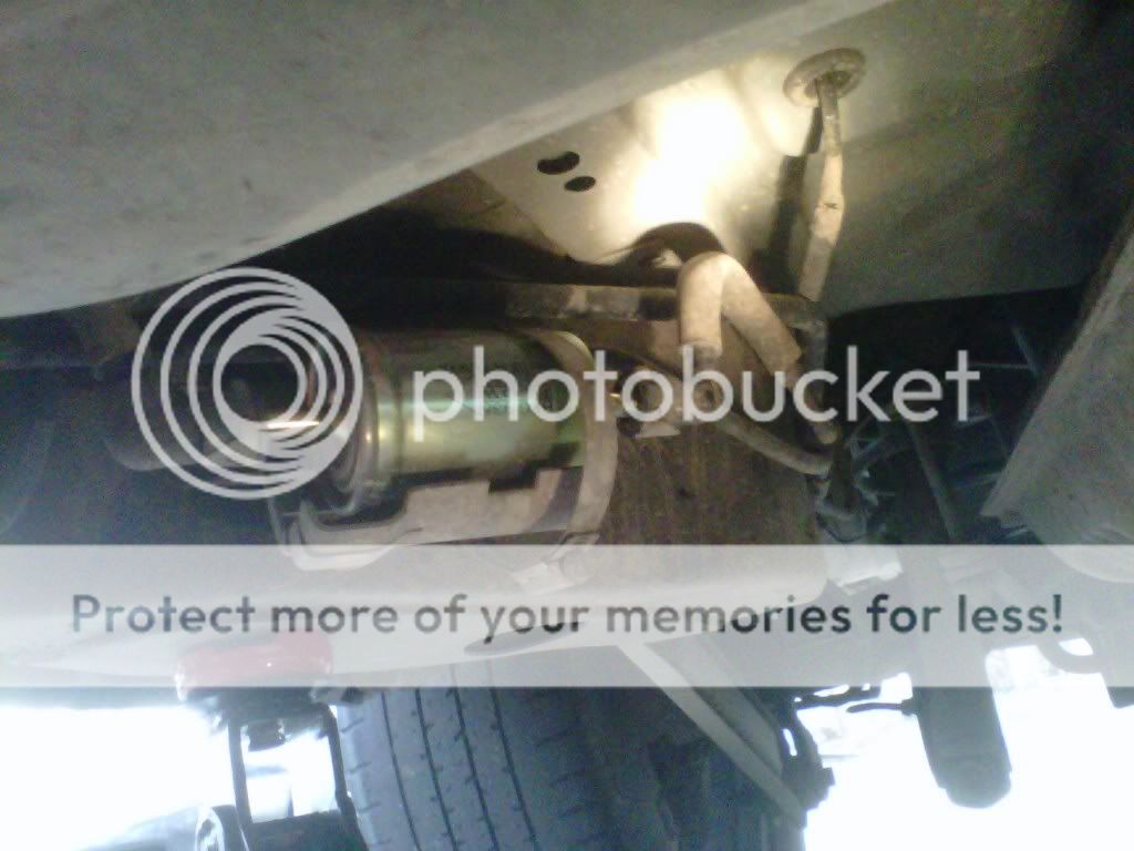

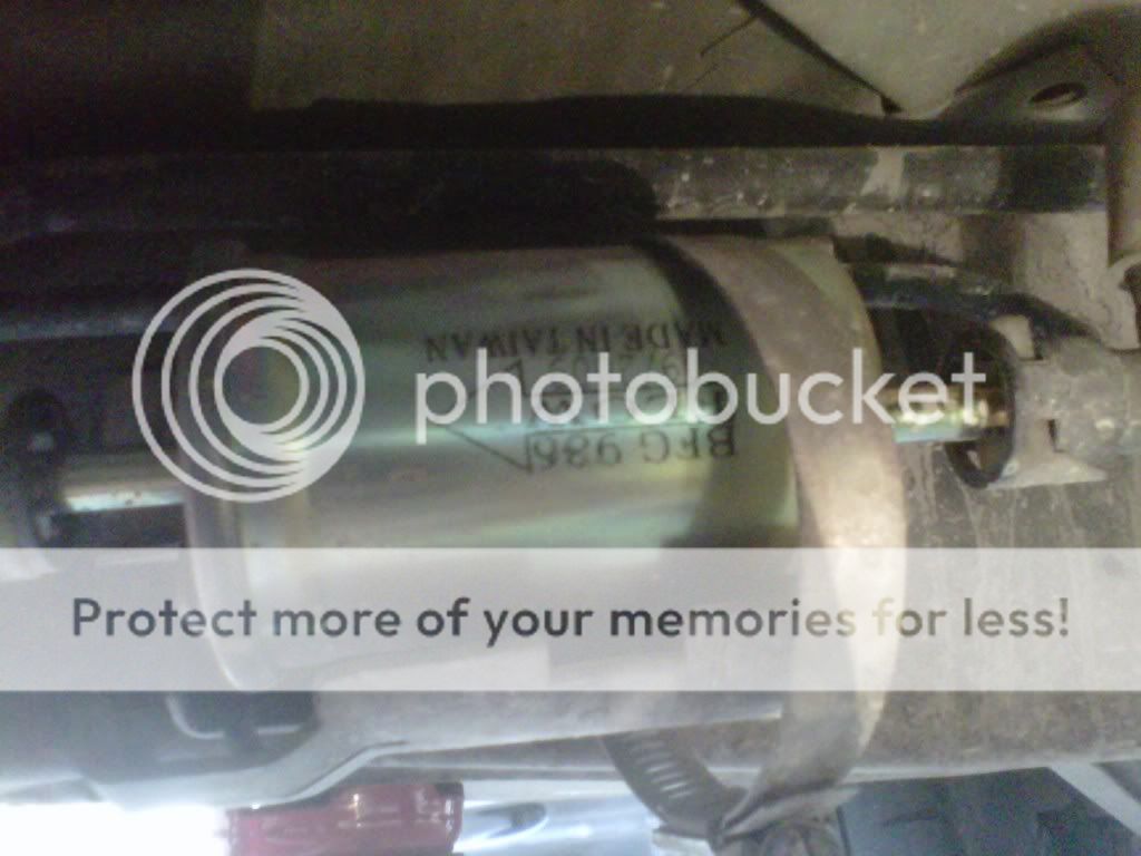

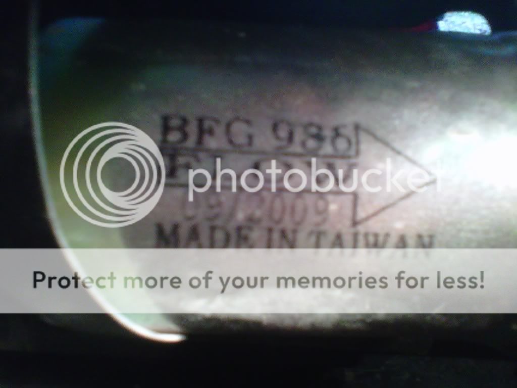

thx well the vehicle is a 1999 crown victoria P71 and unfortunately no i didnt check the pressure before it was installed and it is the right filter and the arrow is facing towards the engine but someone told me that Replacing the fuel filter removed a restriction. Your fuel pump was compromised due to the restriction in the old fuel filter. Consequently the problem is now showing because the fuel pump is working into a lower load and is having trouble keeping up. If you had not replaced the fuel filter you still would have had failure in short order. It is just that the fuel pump would have failed without warning. Fuel pumps working into a restriction work at a much higher load and as a result will wear much sooner than a pump working into a low restriction load.
what you think?

Since you don't mention the vehicle you are working on or the model year, I'm not sure this is possible, but did you make sure the fuel filter is installed correctly? Many vehicles have directional filters on them with arrows printed on the housing indicating the fuel flow direction. I don't imagine you took fuel pressure readings immediately before changing out the filter, did you?
-Rod
what you think?

shorod
03-24-2010, 10:17 PM
You've got the direction correct.
I would agree that a fuel pump working in to a load will fail sooner than one not loaded, but the rest of the logic I don't follow. Sadly though I don't have any suggestions for you on why your vehicle runs worse now than before the new filter was installed. If the fuel pump is original it's not unlikely that your 1999 would be due for a replacement though.
