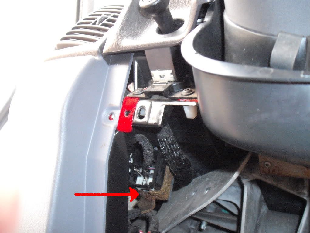

Your year uses a combination hazard/turn signal flasher that could be your problem. It's located in steering column. Since you've taken it apart already to do the switch, the flasher should be easy. Here's a pic (courtesy of Hubs97xj on NAXJA).i It's the gray "relay" plugged into that black connector with foam tape on it.
http://i266.photobucket.com/albums/ii244/AHhub/forum%20stuff/DSCF5363.jpg
