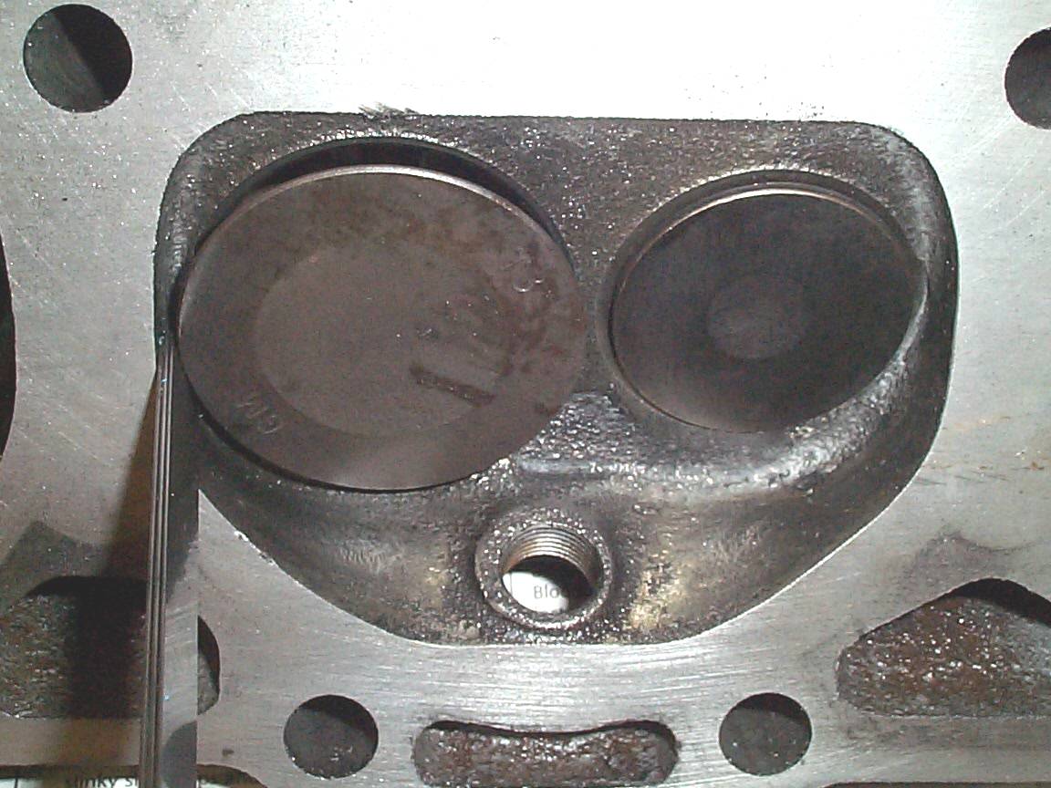

Regardless of which head you select, valve shrouding is a problem in either of these castings. Even with the 1.84 valves the tight chambers create a shrouding issue. If you can't stack at least 0.080" of shim between the valve perimeter and the chamber wall, that portion of the valve is all but useless.
http://www.wwdsltd.com/files/ChamberShrouding01.jpg
I feel it is far better to add a few CCs of chamber volume to insure perimeter flow than to try to maintain a higher static CR and ignoring the shrouding. Even with more chamber volume, the true, dynamic CR will be higher and power/efficiency will be improved by opening the chamber to allow full perimeter valve flow. You can also improve perimeter flow with a radius on the front (face) side of the valve as much as with a multi-angle seat grind.

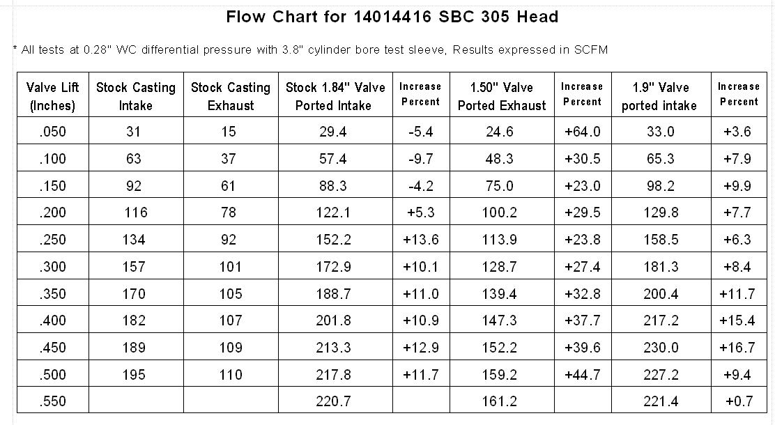

And cam selection will be crucial. The factory, despite all our lambasting, seemed to know exactly what it was doing when it installed all those "peanut" cams in 305s. The measured head flows didn't improve much at all above 0.400" lifts, so a higher lift cam does almost nothing with stock heads. It is more important to get the valves opened and closed as quickly as possible to the 0.350-ish range than to open them to 0.550" where flow is really not significantly better than at 0.400":
http://www.wwdsltd.com/files/416FlowTable01.jpg
If you perform some head work the flows improve at higher lifts, but again the increase in flow beyond 0.450" is negligible, and it is far more important to plot the time under the curve than to consider peak lift as the determining factor in selection.

No, the gasket won't "help". The area nearest the cylinder wall is where the mixture comes flying down the runner and "slams" into it.
Blue Bowtie is correct. "Unshrouding" the intake valve will improve power more than "saving" the small amount of compression "lost" to chamber mods. We use a "Mira" cutter to open the area around the valve.
