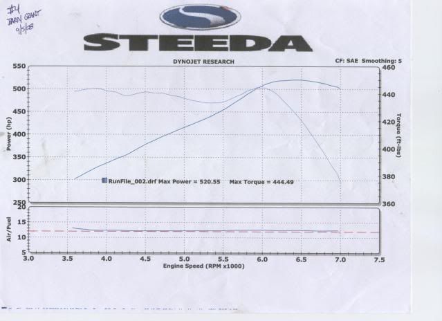

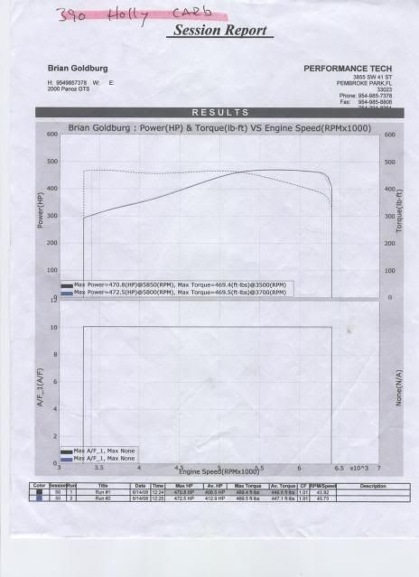

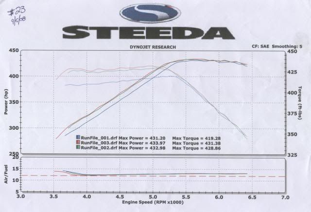

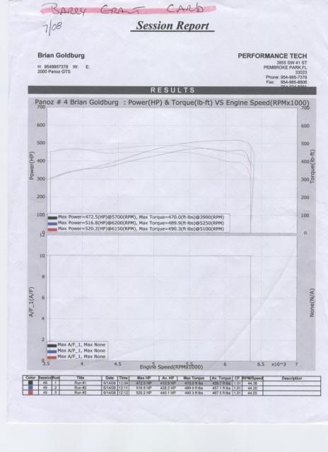

Attached are the last dyno sessions we did with both 390 carb and the 650 carb. As you can see from one car to the other and from dyno to the other the results VARY. This really annoys me since my class in NASA is a dyno based racing league and I cannot tune with any kind of confidence. Could you imagine me dyno tuning the car in Florida, buying a special built carb to get as close as you can to the allowed limit and then go to nationals in Utah and their dyno reads illegal? Now what? When we got dyno checked in Ohio at nationals their dyno read 420 RWHP with the 390 carb which is 30 HP less than the "SAME" dyno in Florida.
390 CFM #4 DynoJet
http://i614.photobucket.com/albums/tt222/panozracing/dynosheets2008001.jpg
390 CFM #23 DynoJet
http://i614.photobucket.com/albums/tt222/panozracing/dynosheets2008.jpg

650 CFM #4 Some other dyno (I forgot the brand)
http://i614.photobucket.com/albums/tt222/panozracing/dynosheets2008004.jpg
390 CFM #4 Some other dyno (I forgot the brand)
http://i614.photobucket.com/albums/tt222/panozracing/dynosheets2008005.jpg

Thanks Brian, very interesting. Yes it is pretty hard to run on the edge with inconsistencies like that. I guess all you can do is learn from year to year and anticipate the benefit offered by one dyno over another. The inconsistencies are the very reason I always use the same dyno every time I tune the car.
Love that 427 torque curve. I am guessing it would be pretty hard to harness that much torque with DOT's over an endurance race - even with the likes of 315's. Rear tyre heat/wear would definitely be more of an issue!!
