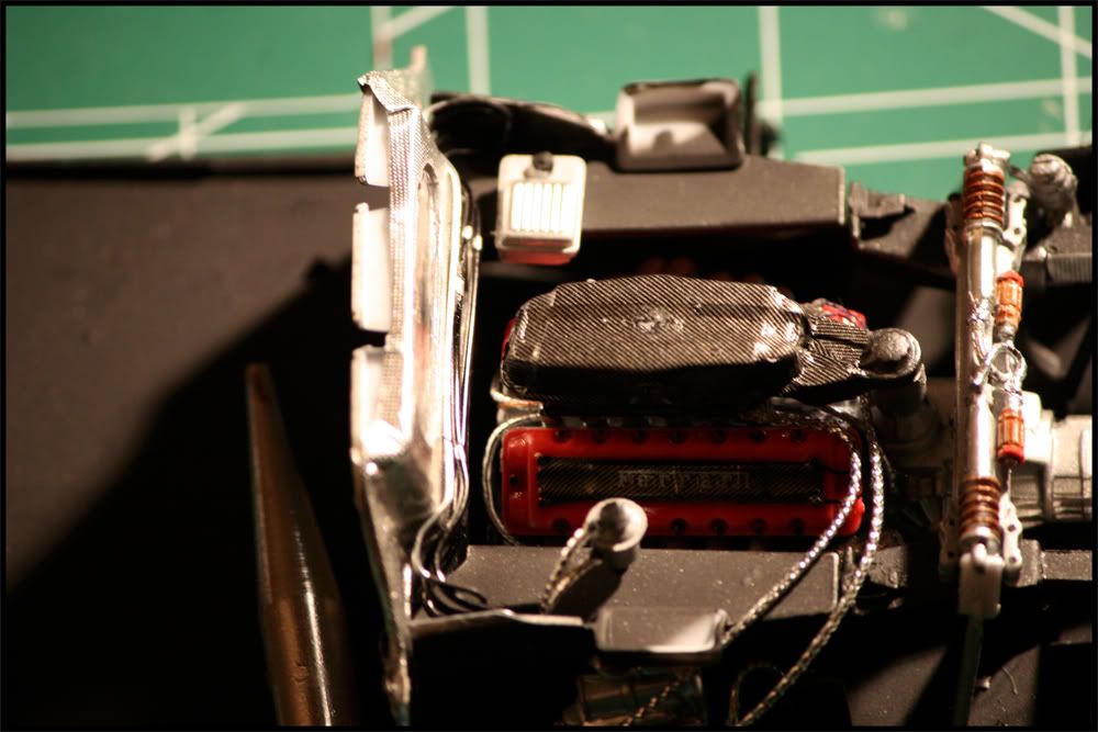

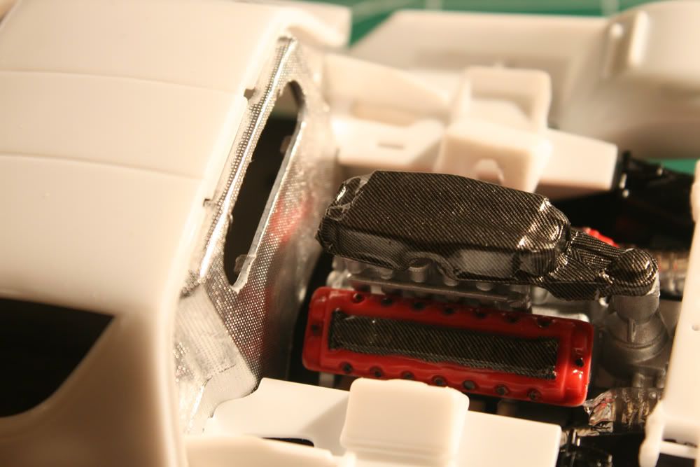

hey guys, so in the process of starting modeling back up after not doing it since of school scheduling, i decided to give a Ferrari a try since all of my other builds are Turbo Supras... i wanted to switch it up a little, only thing that wont change for this build is some custom detailing as well as a completly custom Twin Turbo set up :) as far as I can tell there hasnt been a Twin Turbo Enzo to this day, atleast not that I could find records of pics off... (if you know of one please let me kno where i can find it) but anyway, on to the 2 quick pictures:
carbo fiber on the valve covers:
http://i145.photobucket.com/albums/r209/aemravan/1-24%20scale%20supra/IMG_1188a.jpg

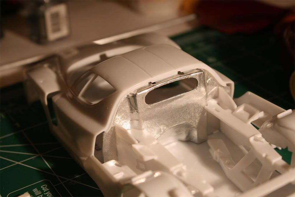

and here is the firewall and my first place for modification, original kit says to paint it silver, but i decided to go the actual way and put on some heatshielding :)
http://i145.photobucket.com/albums/r209/aemravan/1-24%20scale%20supra/IMG_1194a.jpg
let me know what you think and sorry that you can see where the turbos are going yet, i promise to try to get to that point really soon, ive just never had to deal with a model that has ALL WHITE components that absolutley need paiting before installing, keep posted :)

rollin80s
02-25-2010, 03:09 AM
can't wait to see the turbos. will be checking this one out.

Wolf95
02-25-2010, 10:53 AM
what did you use for your "heat shield"?
ravan17
02-25-2010, 10:57 AM
inside of a cigarette box :) works perfectly and is free if you know smokers :)
Wolf95
02-25-2010, 11:05 AM
any certain brand? (I dont smoke) I didn't know the insides were textured like that lol
ravan17
02-25-2010, 11:59 AM
im not a smoker either, i think it doesnt matter, i found this box that my dads friend left at the house years and years ago, im not sure if they are all textured like that but i think they might be... if i recall correctly there is even some that are like a stained yellowish tint to them, or bronze, im going to try and see if i can collect some more. The one i used above, if im not mistaking.., was from a Malbaro box which was atleast 3 or 4 years old... not sure if that matters or not.
i'll look around and let you know what i find.

Exotics_Builder
02-26-2010, 11:23 AM
This is also available from Model Factory Hiro in an adhesive version
carl63_99
02-26-2010, 11:40 AM
I've seen many other products have similar foil with patterns. Take a look at Pringles potato chips, yogurt or cottage cheese containers, or any product that has a sealed foil cover. I think I've got cottage cheese foil on my 348 twin turbo firewall.

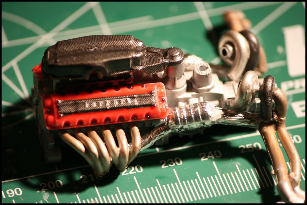

ravan17
02-27-2010, 12:39 AM

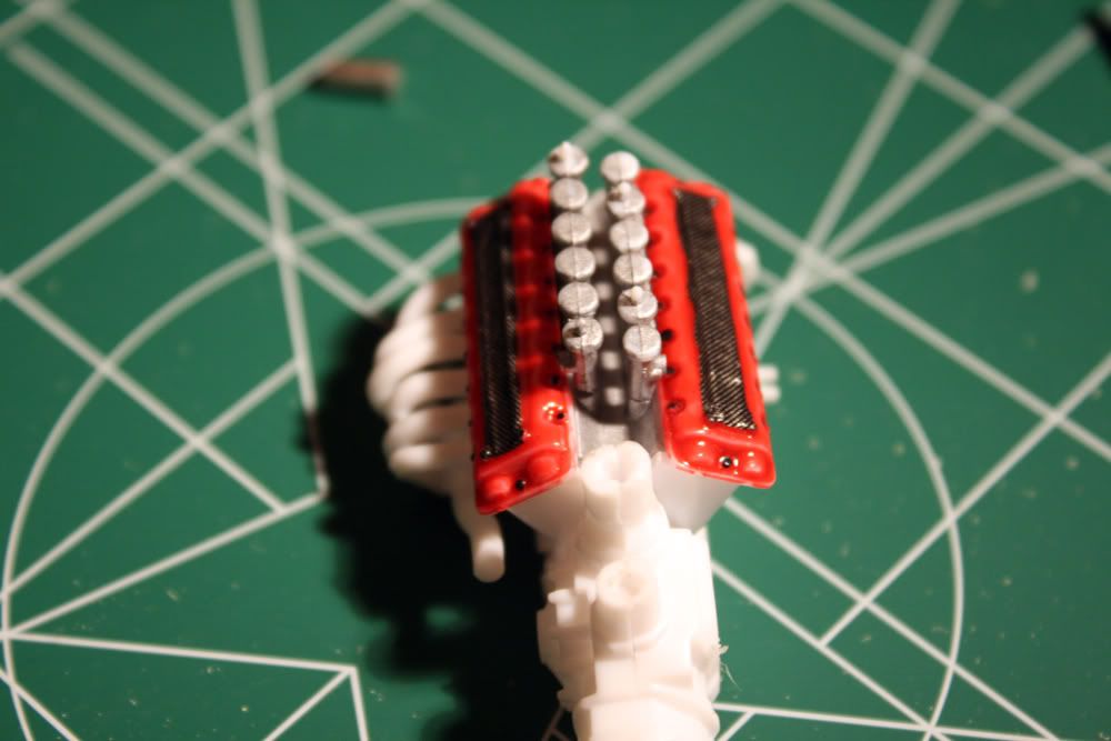

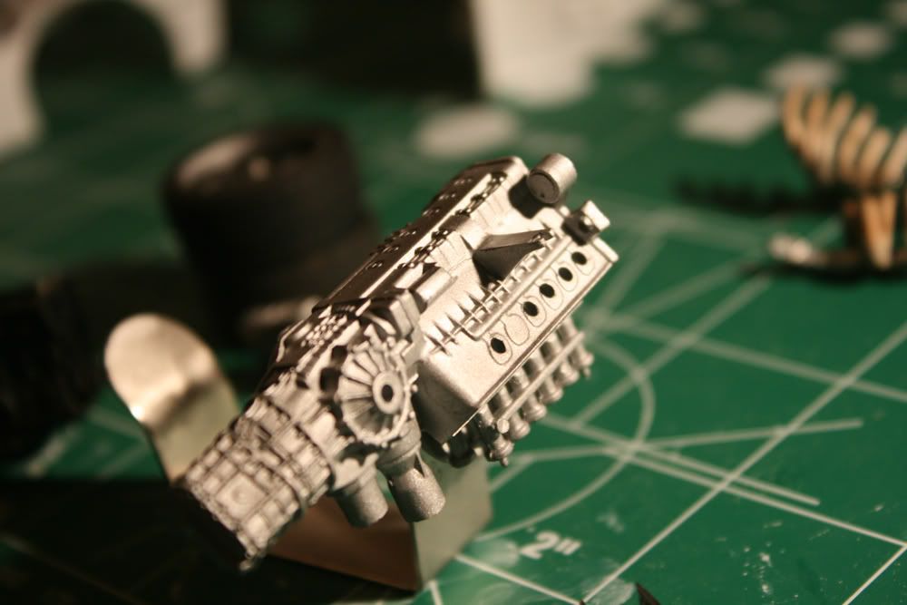

well i finally started making some real progress with the enzo.
painted the block
http://i145.photobucket.com/albums/r209/aemravan/1-24%20scale%20supra/IMG_1199a.jpg

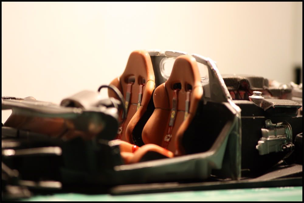

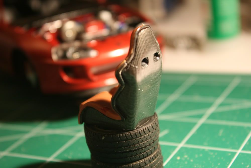

wrapped the seats in carbon fiber and painted the seats in baige leather
http://i145.photobucket.com/albums/r209/aemravan/1-24%20scale%20supra/IMG_1205a.jpg
painted the headers and wrapped them in heat wrap
http://i145.photobucket.com/albums/r209/aemravan/1-24%20scale%20supra/IMG_1207a.jpg
http://i145.photobucket.com/albums/r209/aemravan/1-24%20scale%20supra/IMG_1210a.jpg
modified the intake box to accept the turbo lines latter and wrapped it in carbon fiber
http://i145.photobucket.com/albums/r209/aemravan/1-24%20scale%20supra/IMG_1212a.jpg

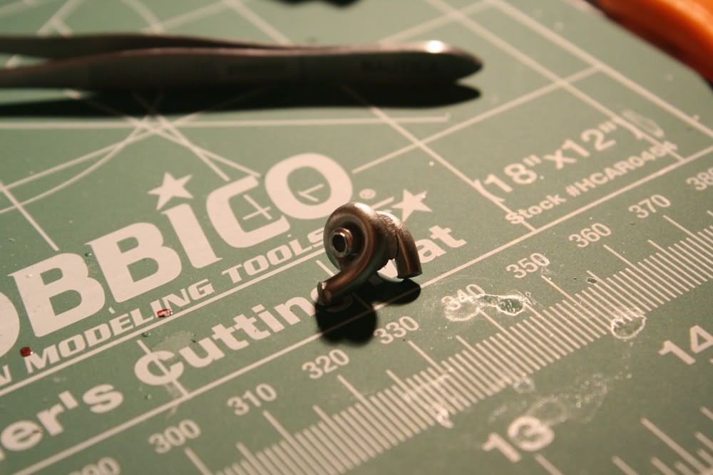

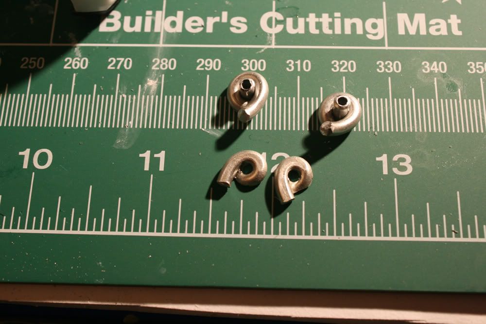

starting the turbo build
http://i145.photobucket.com/albums/r209/aemravan/1-24%20scale%20supra/IMG_1211a.jpg
http://i145.photobucket.com/albums/r209/aemravan/1-24%20scale%20supra/IMG_1215a.jpg
almost done, just need to add accessories, lines, polish it, heat shiled, etc
http://i145.photobucket.com/albums/r209/aemravan/1-24%20scale%20supra/IMG_1216a.jpg
test fitting
http://i145.photobucket.com/albums/r209/aemravan/1-24%20scale%20supra/IMG_1217a.jpg
http://i145.photobucket.com/albums/r209/aemravan/1-24%20scale%20supra/IMG_1218a.jpg
http://i145.photobucket.com/albums/r209/aemravan/1-24%20scale%20supra/IMG_1219a.jpg
i still need to figure out eactly how im going to run the intake and compression line to and fomr the turbos... the exhaust side is going to work out perfectly, all i have to do is add in a 90 degree exhaust pipe and i can keep the factory exhaust piping out to the tail pipes.
i basically need to run a line into the middle of the turbo form the oute two airfilter boxes and run 2 more lines into some sort of aftercooler and into the CF intake box.
what do you guys think?

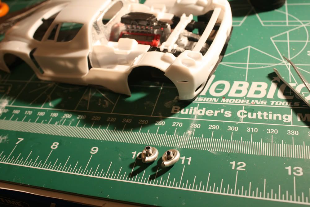

ravan17
03-02-2010, 11:28 PM

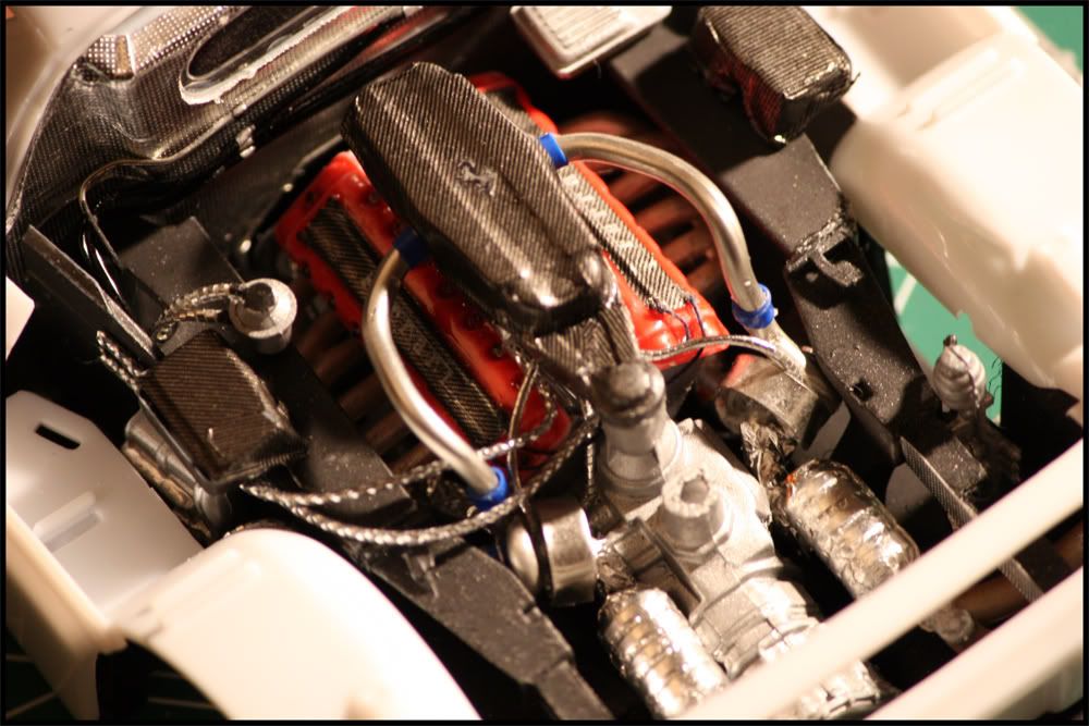

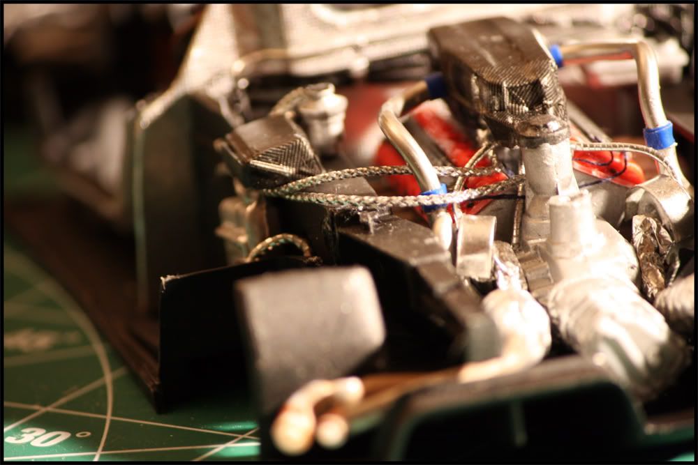

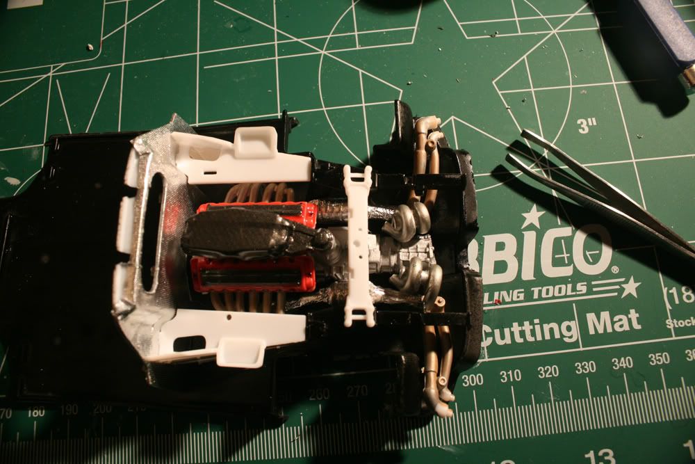

here are a couple of quick updated pics on the TT enzo. I finally got the turbos mounted where they will sit and am now just working out clearance issues... its a damned tight fit, no wonder no one has turboed an actual enzo yet... i still need to touch up the connection between the turbo and the plastic exhaust pipe to make it flow better, and once i get around to painting all of these components everything should start coming together, especially the engine wiring and plumbing.
http://i145.photobucket.com/albums/r209/aemravan/1-24%20scale%20supra/IMG_1425a.jpg
http://i145.photobucket.com/albums/r209/aemravan/1-24%20scale%20supra/IMG_1432a.jpg
http://i145.photobucket.com/albums/r209/aemravan/1-24%20scale%20supra/IMG_1436a.jpg
http://i145.photobucket.com/albums/r209/aemravan/1-24%20scale%20supra/IMG_1437a.jpg
when the body is on the car you can see the turbo set up from the back side where the mesh goes, it looks pretty cool. now i just gota start working out the details to make it look more realistic.
Wolf95
03-02-2010, 11:40 PM
swwweeeeet. did you have a hard time with that cf on the intake??
ravan17
03-03-2010, 12:00 AM
yea... but i think its because im fairly new to CF decals.. i can lay them really good on straigh surfaces that have minimal curves... but things that have multiple curves in tight spaces i find a bit hard to do.. thats why you see it over lap over by the cap the way that it does. And i also made that out of a little piece of scrap of CF decal that i didnt want to throw away so i couldnt really cut it the way it should have been.

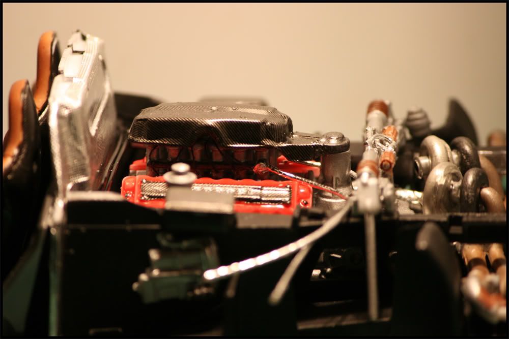

ravan17
03-03-2010, 11:48 PM
I had some time today after school to start putting some major components together. I started the wiring process as well as running some pluming lines for fuel and what not. Im probably about 15-20% done so the wiring you see is just the beginning (or so i hope :)) . As you can see the interior is pretty much done and the drivetrain will be next to come together, but that wont be until after i install the motor with the complete wiring. Im not sure on what color to paint the body yet...
here are the pics:

drunken monkey
03-04-2010, 12:03 PM
as far as I can tell there hasnt been a Twin Turbo Enzo to this day, at least not that I could find records of pics off... (if you know of one please let me kno where i can find it)
Someone on the boards built a twin turbo Enzo a while back but I'm not if he ever completed it.
However, what is good in his thread is that it shows a much better (if it were real) placement of the turbos compared to where you have it.
Putting two objects that both get very hot during use right next to the gearbox is not the best thing in the world.
By the same token, you might want to have a look at Turbo'd Group C Le Mans cars to see how they did it.

Nice progress, but i think you should use better turbos as your don't look realistic. Keep us posted.

Thanks for the constructive input guys, thats exactly what i need.
Drunken Monkey, i wish i would have see it earlier.. i know thel ocation isnt completley realistic where they are now but i dont know if i could make a turbo small enough to fit where its right downstream from the collector.. maybe next time i'll do a bit more research before i throw myself at a project like this.. but i guess for now i will just add more heat shielding to the turbos and surrounding areas as well as maybe creating a blanket for the hotside on each turbo.
Midmaz, could you comment on what aspect of the turbo does not look realistic please? I belive it might be the fact that i have not ran the intake pipe with couplings to it yet? Please let me know as I would like to correct anything that looks out of place before things start to get glued in.
what he means is that a turbo is more than two coils of pipe around another straight one. There are extra details like various connection flanges, fins for cooling purposes, secondary ports for ancilleries and sensors etc etc.
thanks guys.
The two housings seem to be too far apart. They aren't perfect circles. Also a little clean up to make them look better.
For future projects, try thepartsbox.com as they have really nice resin turbos. Also search 1/24 resin in ebay and a few turbos will pop up for cheap. Makes things easier also.
Good luck. The motor looks good.

ravan17
03-06-2010, 02:04 AM
Here is a quick update:
http://i145.photobucket.com/albums/r209/aemravan/1-24%20scale%20supra/IMG_1451a.jpg
http://i145.photobucket.com/albums/r209/aemravan/1-24%20scale%20supra/IMG_1449a.jpg
http://i145.photobucket.com/albums/r209/aemravan/1-24%20scale%20supra/IMG_1455a.jpg
http://i145.photobucket.com/albums/r209/aemravan/1-24%20scale%20supra/IMG_1458a.jpg
as far as the turbos go, i def will clean them up and add more hardware, they are by no means fnished as you see them . I am also working on a heat shielding plate that would divert the heat from the turbos instead of allowing it to go straight to the gearbox. i will keep you guys posted.

star21
03-06-2010, 04:47 AM
It's at least a valiant effort that you're doing. To be honest, it doesn't seem like many people put much detail work in the CRHA (center housing between the Compressor and Turbine), anyway.
The trim size does look a bit big for scale but it's understandable since it's quite hard to scratch build a small/moderate trim turbo and still get stellar detail into it. Generally when you're running twins they're a bit smaller than a large single (your scale looks a bit like a standard T88). The distance between the two housings doesn't seem too bad considering the scale size you're going for. I'd assume since you angled the compressor that's what is causing it to look too far apart. You may want to clean up the back of the compressor housing and flatten it out a bit of all that excess putty work to give it more definition.
The turbo placement probably would've been better if you had taken out the catalytic converters as it does tend to take up a load of engine bay space. Who the heck needs to worry about being "green" with a scale model? :rolleyes: That would've been a better spot to start the turbos than its existing location. Another idea would be to put place it exactly where the gigantic OEM muffler would be and have the turbos placed facing each other (compressor facing compressor).
Also, the exhaust routing is off. All the exhaust tubes seem to lead straight into the turbine without a method. One portion for the downpipe is correct but the other exhaust tailpipe connects directly to the turbine inlet. This inlet would be exclusive for the exhaust tube from the manifold to feed the turbine with exhaust gas.
Of course that might be WAAYY too technical for a scale build but it's always a good learning experience. I do apologize if it seems like I'm ragging on you (which I'm not). Just thought I'd add some thoughts to improve your build. Keep up the work! :smokin:
BTW, are you planning an intercooler setup for this as well?
ravan17
03-06-2010, 09:35 AM
thank you for the very constructive input man. You gave me heart to relook at the set up :)
current location of the turbos is actually exhaust where the OEM muffler sits... the turbos mound to the little connecting points for the muffler.
I do see what you are talking about with exhaust routing, the portions that feed the turbine would not also be dumped into the atmosphere as that would cause no kind of turbo effect since the ehxaust gas would choose the path of least resistance, (out of the exhaust), i need to address that. As far as sizing goes.. i do believe its about the size of a standard t78 rather than 88, or maybe somewhere in between.
i dont know why i left all that excess on the back of the turbos.. rookie mistake. But its not putty :) its all made from solder so i just need to take those off and adress that issue.
the reason i didnt want to take out the cats was because i was really happy with how they came out wrapped in the heatwrap.
i really wanted to keep the turbos where they are because if i took them out there would be a large open area unless i put the factory muffler back in.. should i just go that route if i can make a turbo small enough to fit where the convert goes?
thanks again for the input, im off to work :)

well i took the advice given and here are the results so far :)
resized turbos, relocated, and ran oil feed and return lines to the center cartridge, here are the results after tonight... its still not 100%, theres still areas for improvement and things like that.... let me know what you guys think..
http://i145.photobucket.com/albums/r209/aemravan/1-24%20scale%20supra/IMG_1464a.jpg
http://i145.photobucket.com/albums/r209/aemravan/1-24%20scale%20supra/IMG_1462a.jpg
http://i145.photobucket.com/albums/r209/aemravan/1-24%20scale%20supra/IMG_1459a.jpg
countach79
03-11-2010, 12:16 AM
Sweet! heat shields for the turbos look good and i like the plumbing coming from the turbos!
keep it up
keep it up
ravan17
03-11-2010, 12:21 AM
thanks man!
Wolf95
03-11-2010, 01:04 AM
what did you use for those pipes coming from the turbo?
star21
03-11-2010, 01:26 AM
Looking good. Inspires me to undertake such a project in the far future. I hope you won't mind. :biggrin:
ravan17
03-11-2010, 01:29 AM
thanks guys.
The pipes are made out of the same material all of the turbos are, solder wire. I finally went to home depo and got myself a thinner wire b/c hte thicker one i had (the one for all the supra turbos) was too big and i just couldnt get them small enough for the enzo...so i had to get something a bit smaller in diameter

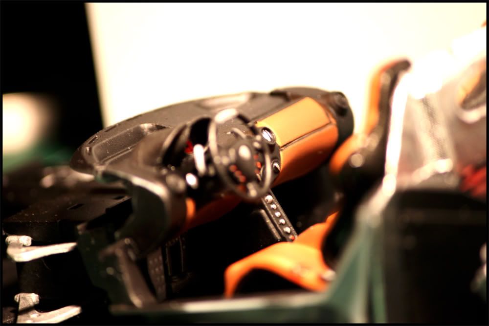

04-22-2010, 01:10 AM
almost finished, going into the finished stages, I gota say.... i am REALLLLLY diaspointed with the fitment of the overall kit as far as the body/chassis is concerned.. hatch doesnt line up, body doesnt sit right, ect... i tried to sand here and there, tried to bend some parts to make them fit, they got better but still doesnt look like it should.. I guess i dont really mind that the hatch doesnt close b/c it will be open to show off the turbos.... hopefully in a few short weeks this one will be done, the one thing i STILL havent learned to do is masking the windows and painted the trim around them... i absolutely suck at that and messed up the front windonw.. i think im just going ot try to cut it out of something to resemble the front glass b/c it really makes the model look fake.. if nayone has suggestions on masking windowns please let me know.
here is what the color looks like, its a gun metal flat color:
http://i145.photobucket.com/albums/r209/aemravan/1-24%20scale%20supra/IMG_1932a.jpg

04-22-2010, 06:19 AM
looks nice!
The tamiya enzo is FAR better than this 1 tho it does have issues with the rear hood aswell
again you have done a really nice job on this 1, love the colour
