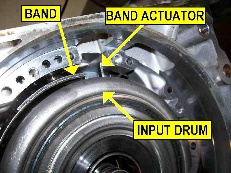

As for any adjustments, there truly are none. The older Hydramatics had adjustable band anchors which set the relaxed point of the band. Newer transmissions are designed with more than adequate overtravel in the actuator pistons to automatically adjust for any band friction material wear.
Incidentally, your trans has only one band, and it is used to clamp the input drum into position and force the input shaft to drive through the planetary gearset rather than directly, providing the necessary reduction ratios for the Reverse and Low ranges.
It's a little like this (pardon my mess):
