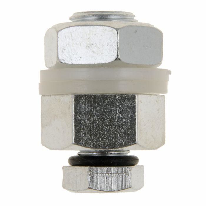

It might also be a really good time to install a drain plug in the pan if you can tack weld a nut on the inside:
http://www.wwdsltd.com/files/TransPanPlug.jpg
You can also install a prefabricated drain plug kit but they tend to hang down even farther:
http://contentinfo.autozone.com/znetcs/product-info/en/US/drm/65128/image/8/
