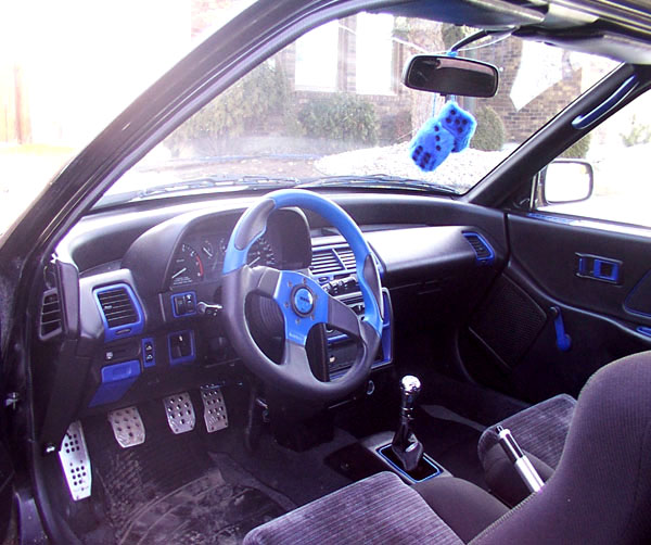

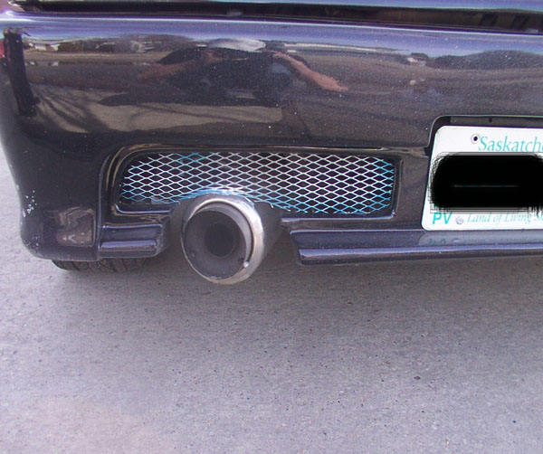

Well half of it. I didn't get the side skirts to fit but here is the front and the fuggered back. The front has a warp as you can see. Then there is the nice mesh that the manufacturer painted blue. and the exhaust that didn't fit so the shop cut the bumper and bent the mesh.(which I will replace soon) Then there are just some other pics. Sorry about the wait on the pics i was in BC for a week.

i love the blue accents on the interior. What kind of paint did you use for it?

I bought the momo steering wheel and then took it to a shop and they matched the paint to the center of the wheel. It is special paint for vinyl and plastic!

care to share the make/brand of the paint? I'd love to do little accents like that but in red on my civic

I don't have a clue what the brand was. I just took it in and asked if they could match it. Try supply shops for automotive paint.

oh okay i thought you did the blue paint on the vents etc.

I did do the vents and all that myself. I just got the paint from them.
