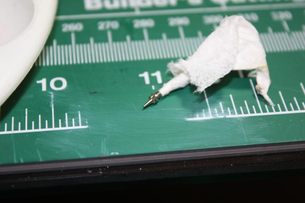

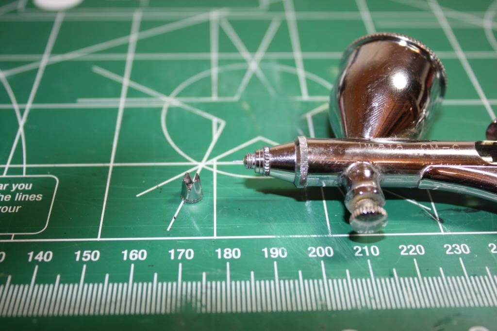

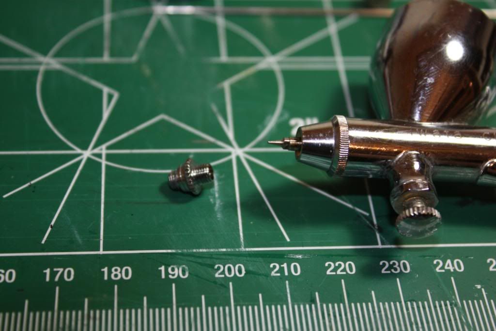

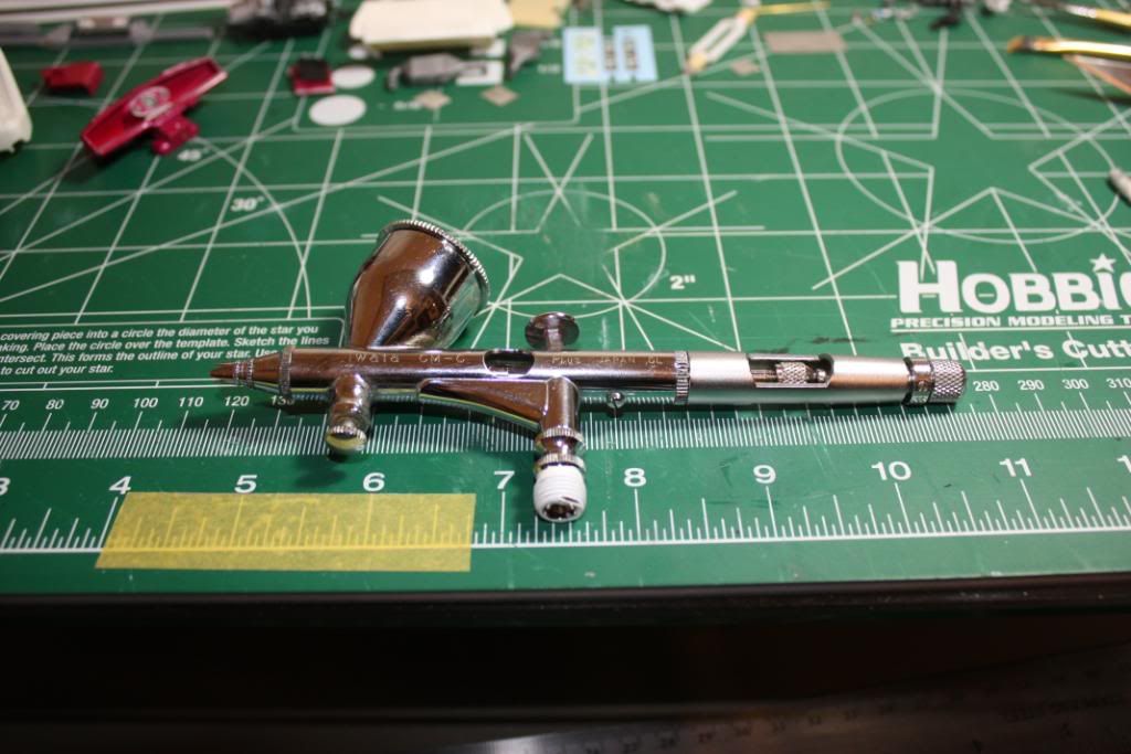

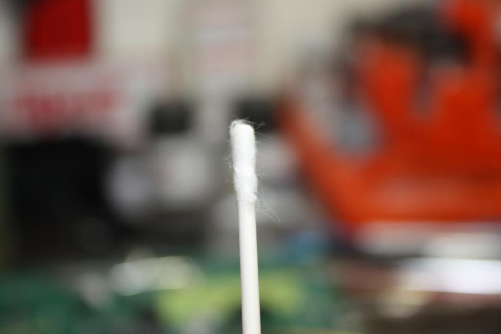

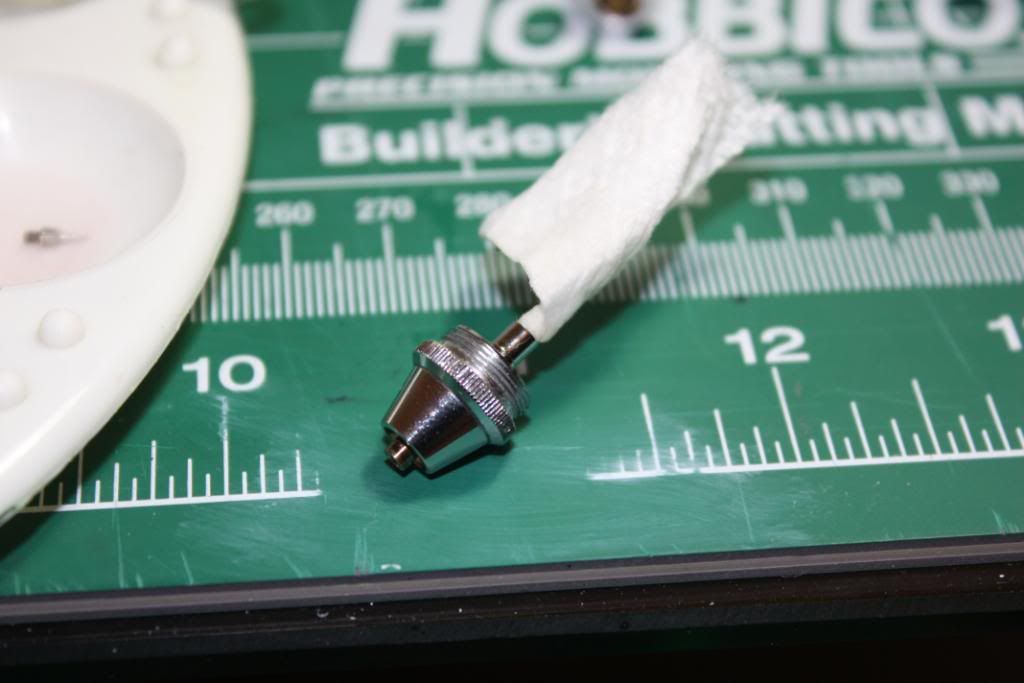

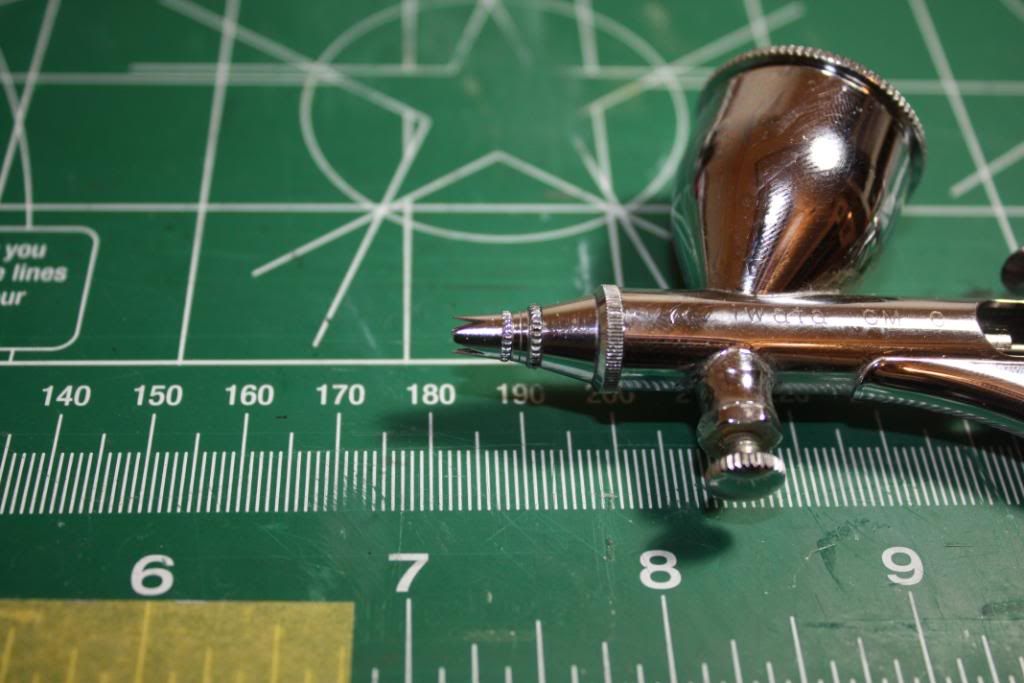

ok so heres my best explanation of how to clean and lube your airbrush, I'm not too familiar with the Eclipse line but I'm sure they are similar.
first dissasembly.
http://i239.photobucket.com/albums/ff174/mugenhbtyper/IMG_5758.jpg
http://i239.photobucket.com/albums/ff174/mugenhbtyper/IMG_5761.jpg
I'm not sure if your gun has this part but it is removable and is there I'm asuming just to protect the needle itself, but I have noticed when I have sprayed with it on that paint will accumulate on the little prongs and spit from time to time, so I just remove it while I paint. and am carefull not to damage the needle tip.
http://i239.photobucket.com/albums/ff174/mugenhbtyper/IMG_5762.jpg

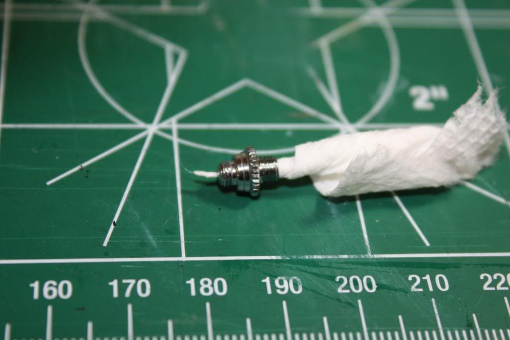

I clean my airbrush with laquer thinner as it removes everything, you can soak your parts too, but I would not recomend leaving them in there too long because the thinner can etch the metal and possibly damage the airbrush parts. I tear off a piece of paper towel and twist it up then dip it in the thinner and insert and twist inside the part, you'll be surprised what will come out even with regular cleaning.
http://i239.photobucket.com/albums/ff174/mugenhbtyper/IMG_5764.jpg
http://i239.photobucket.com/albums/ff174/mugenhbtyper/IMG_5766.jpg
http://i239.photobucket.com/albums/ff174/mugenhbtyper/IMG_5772.jpg
http://i239.photobucket.com/albums/ff174/mugenhbtyper/IMG_5775.jpg

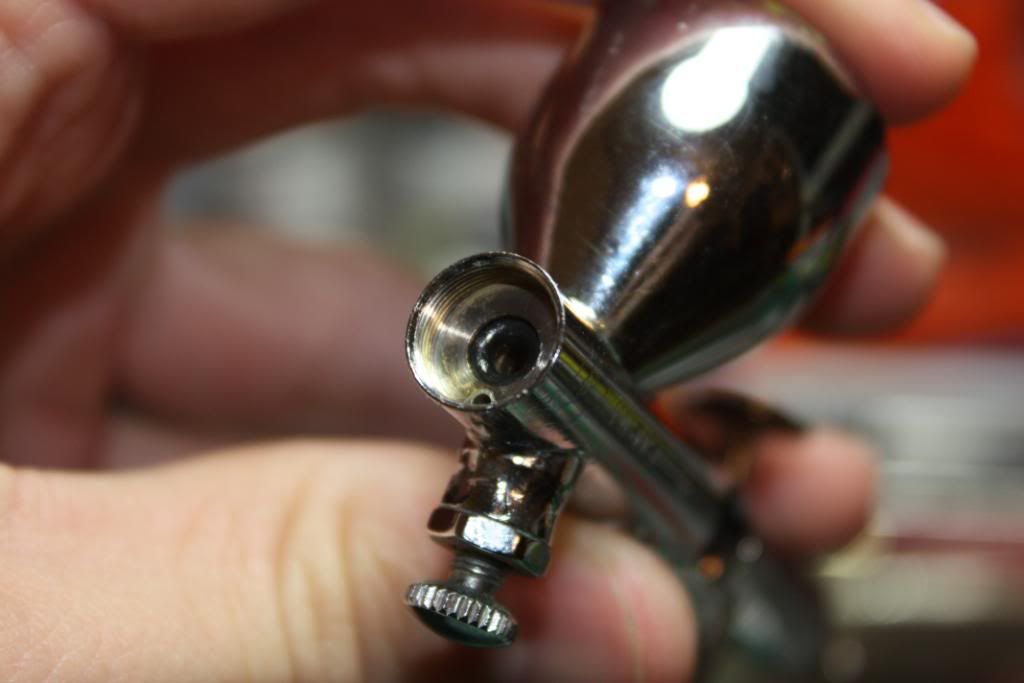

now to the gun itself, there is an O ring in it this is the needle packing at the tip, this has to be cleaned well, I use a Q-tip with most of the cotton taken off the tip and the remainder twisted back tight and dip it in some thinner then clean this area out. this O ring is removable but is very hard to reinsert so I don't remove it every time to clean it but do it maybe every 3-5 times, but this O ring has to be lubed very good. A little too much is not necesarily a bad thing you can blow the exess out after reasembly before you start painting Plus the lube will not have any negative reaction with the paint if it is the proper kind.
http://i239.photobucket.com/albums/ff174/mugenhbtyper/IMG_5767.jpg
http://i239.photobucket.com/albums/ff174/mugenhbtyper/IMG_5768.jpg
http://i239.photobucket.com/albums/ff174/mugenhbtyper/IMG_5769.jpg

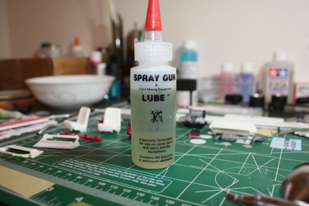

I also lube all threads and any moving parts, this is the lube I use it was purchased from a paint supply store for like 5 dollars and has lasted forever.
http://i239.photobucket.com/albums/ff174/mugenhbtyper/IMG_5760.jpg
Also inspect your needle and make sure the tip is not bent this will cause irratic spraying, and if you look at the needle very close in the light you will see what looks like wear on the needle itself I lube these areas aswell because they are obviosly rubbing on parts of the gun internally.

first dissasembly.
