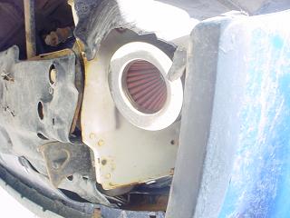

im finally finished making and install my homemade CAI all i got to say it aint that easy u have some fitting and moving around to do ya its all done just have to fix something i had to rewire lights but i fucked it up lol its like not lighting normal ne ways heres the pics tell me what ya guys think

so what ya guys think?

It looks pretty good but why didnt u go all the way to the manifold?

looks...... ok....
why did u use PVC piping tho?
why whouldnt u just use 2.5" or 3" exhaust pipe?
and i agree... go all the way to the manifold.
thats what i'm doin
thats what i'm doin

should i what i do about that sensor thingy?
and i used pvc cuz theres no 90 degree and 45 degree turns i looked

sensor thingy? don't know of one on the intake itself. Yea I think getting some exhaust pipes would work better, because it will be smooth inside, not have lips everywhere. And also probably look a little better too.

i mean the senors thingy look at last pic i left the thing in the right corner that? and whats wrong with pvc not as good?

oh, that little hose. Easy enough, to do, just get a little filter for it. they make them, the hard part is getting that fucker off. Mine wouldn't come off, been on there way too long.

what ya mean filter thingy cant i just like cut a peice of pvc then cut that little senor thingy with the rubber stick pvc on one sdie and another peice on other side?

I mean a little filter. Its a small brether filter for it, its not a sensor. And what you just said made no sense to me man.
And what I was saying earlier. With all those different connections you have made in that short distance on your intake with PCV pipe, there is a shitload of little lips inside that will catch the air and slow it down, so seriously, i don't know how much that helped you. With exhaust pipe, it would be smooth and the air would just go straight through it.

PVC has lips in it so airflow wont be as good, u wont see any changes most likely, also its thicker walled and not heat resistant...
they get enuf heat and they could start 2 melt

thats false it is ehat resistant it will not melt

alright, it might not melt, but it still doesn't help that much over your stock intake.

ill fix that

You should of used a 180 degree bent mandrel pipe.
Club DelSol, or Team DelSol (or sumthin like that) has a How-To on it. I can't remember the address tho.
