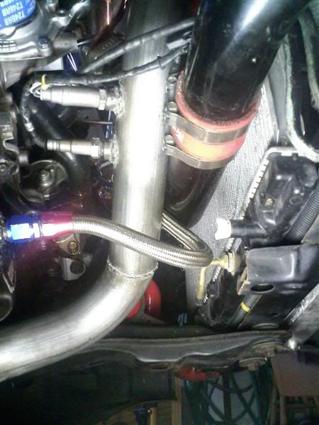

That's right. Keep the piping up high and inside the protection of the car. Granted it's a different turbo setup, but this is how I ran mine.
You can see I go AROUND everything.
http://i59.photobucket.com/albums/g291/david-b/Motor%20Build/1025091754aMedium.jpg
Then inside looks like this
http://i59.photobucket.com/albums/g291/david-b/Motor%20Build/1030092126Medium.jpg
There's some short-route IC setups where the outlets face in toward the engine bay, and just require some minor frame cutting. Plus I want to say only 1Gs really have that full option. But if you just have a universal kit with the outlets on the side, go around the front frame and then up.

Wait, do you have that ic pipe crossing right up against the downpipe? If so, isnt that bad?
david-b
02-09-2010, 09:08 AM
It comes close. The above pic was when I first did the setup, and had a straight coupler coming off the turbo. Now it's a 45* reducer coupler and it moved it alittle farther away. I will wrap the exhaust right there once everything is how I want it. The heat from the exhaust pipe will heat the air in the IC piping, but this is before it even goes through the intercooler, so there'st still more cooling involved.
boostjunkie333
02-09-2010, 09:39 AM
Ok so, if my pipe does happen to come really close to the dp, I can just wrap that section of the dp with heat wrap? I ordered a roll on ebay but never used it..
david-b
02-09-2010, 09:54 AM
Ya. You actually wrap both the exhaust and the IC pipe. If you get a universal kit you can cut everything where you don't have the piping anywhere near the DP. I was limited based on turbo location because of the manifold and how the DP had to join up with the flexpipe.
