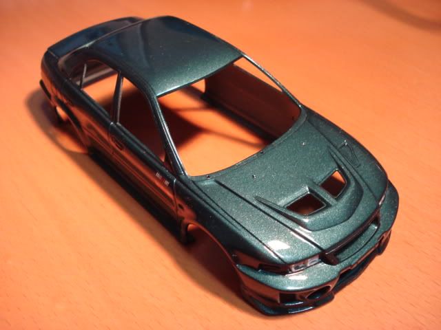

Fujimi body, it looks like a fake Evo 5 right from the start. The rear bumper is as thick as a base Lancer.
So this will be built as a tuned Lancer, without ever considering what it really would have been underneath its Evo 5 replica body kit.
Actually, this is the first body to put on 2K clear, by my uncle, who suggested me testing the clear on some cheap kit body before shooting onto my previous lancer projects. I told him to show me once how to use 2K and then he came up with this near perfect paint job. Only the roof and left fender have been polished, plus some minor dust removal done otherwise.
First modification on this are Virage iO style headlights.

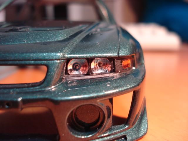

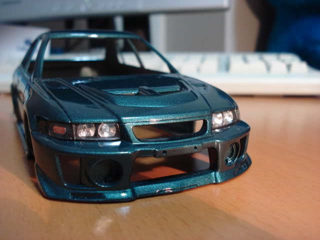

After 3 tries I finally got the light pod size I wanted.
http://i19.photobucket.com/albums/b168/kaho4g94/evolutions2/DSC02661.jpg
http://i19.photobucket.com/albums/b168/kaho4g94/evolutions2/DSC02662.jpg
The original lines on the lens are polished off.
http://i19.photobucket.com/albums/b168/kaho4g94/evolutions2/DSC02663.jpg
Before:
http://i19.photobucket.com/albums/b168/kaho4g94/evolutions2/DSC02665.jpg
After:
http://i19.photobucket.com/albums/b168/kaho4g94/evolutions2/DSC02664.jpg
Edges painted black and almost ready to install.
http://i19.photobucket.com/albums/b168/kaho4g94/evolutions2/DSC02667.jpg

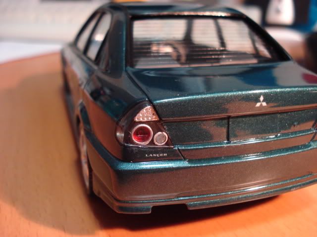

As for progress of the lancer, I decided to do the same treatment as the headlights to the taillights.
http://i19.photobucket.com/albums/b168/kaho4g94/evolutions2/DSC02669.jpg
http://i19.photobucket.com/albums/b168/kaho4g94/evolutions2/DSC02668.jpg
First attempt at any altezza light conversions, while I don't really like these kind of taillights in real life, in 1:24 they look not bad. It's a pain to make them compared to just painted the original lenses especially when you have to drill holes with a full size electric drill on a painted and polished body.

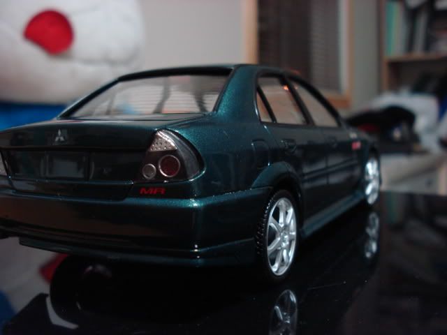

Wheel stance mockup. It was an unexpected amount of work required to fit those XS tuning wheels into the stock struts.
http://i19.photobucket.com/albums/b168/kaho4g94/evolutions2/DSC02670.jpg
http://i19.photobucket.com/albums/b168/kaho4g94/evolutions2/DSC02671.jpg
http://i19.photobucket.com/albums/b168/kaho4g94/evolutions2/DSC02672.jpg
http://i19.photobucket.com/albums/b168/kaho4g94/evolutions2/DSC02673.jpg
Doesn't look like it needs a lowering job.
For the headlights, there isn't much secret. The bowl in one light was made using a drill bit going halfway into a rectangular styrene beam, then the beam is cut and parts of the drilled circle was sanded flat. It is then painted and BMF was applied.

Thats low enough? You must be kidding.

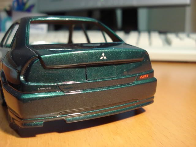

I decided to not use the little foil stickers for the rear turn signals, but made an LED panel instead. First attempt ever, I think it looks decent for the ebay look. Basically just drilled 0.3mm holes on very thin styrene pieces, then covered with BMF. The fact that the body has lopsided taillights is now even more apparent.
http://i19.photobucket.com/albums/b168/kaho4g94/evolutions2/DSC02676.jpg
http://i19.photobucket.com/albums/b168/kaho4g94/evolutions2/DSC02677.jpg
http://i19.photobucket.com/albums/b168/kaho4g94/evolutions2/DSC02678.jpg
