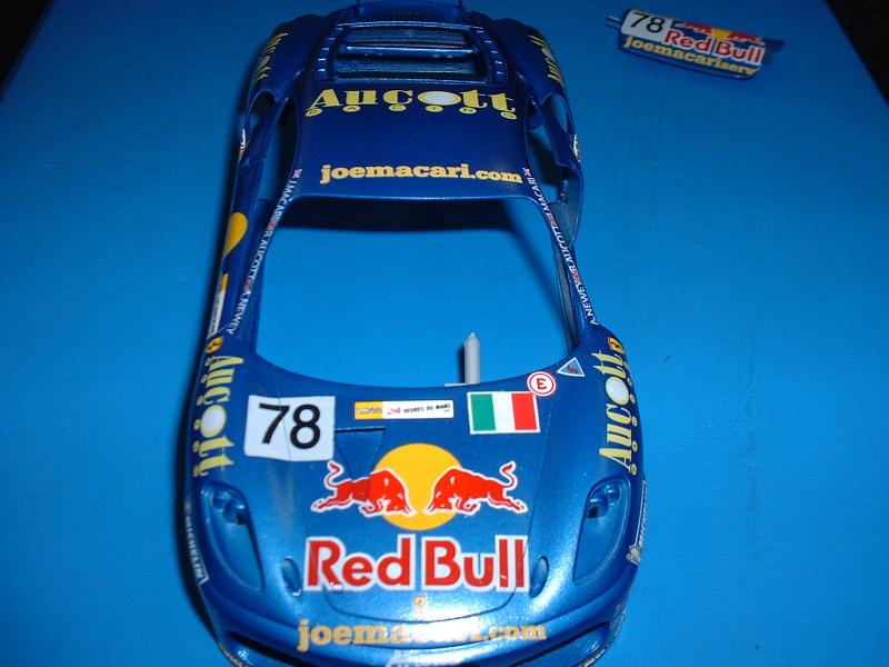

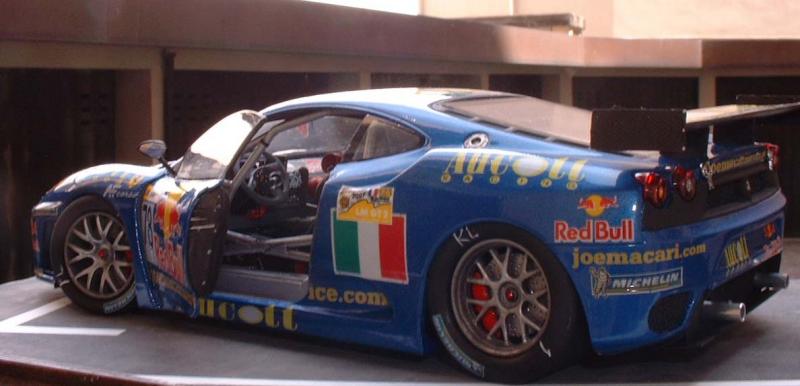

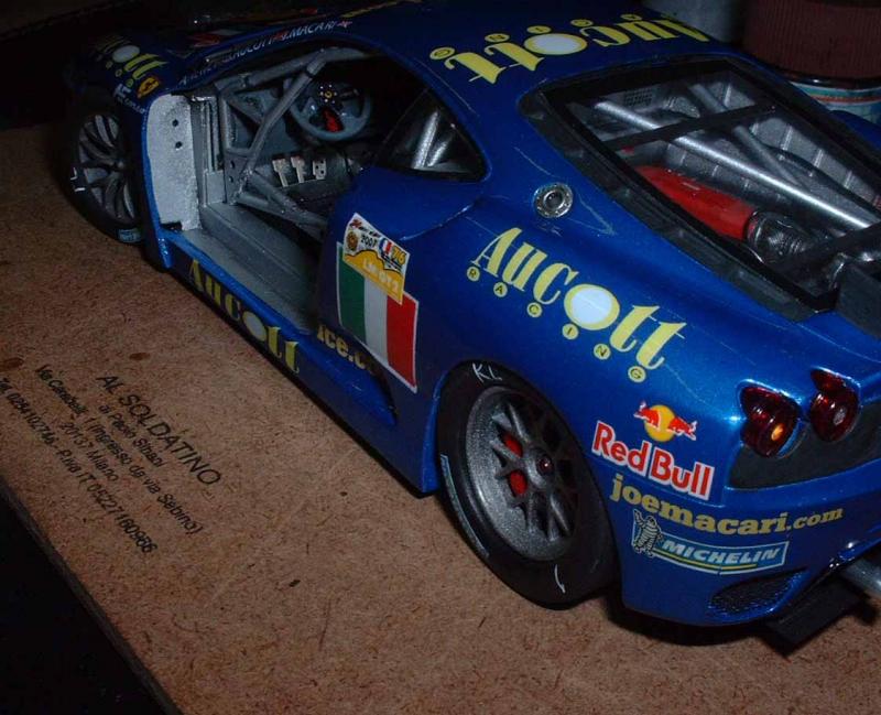

ah..just forgot to show how the final car should look:
http://www.modellismo.net/forum/attachments/statico-work-progress/41337d1236285331-auto-f430-gt2-lm-af-corse-1-24-7847.jpg
http://www.modellismo.net/forum/attachments/statico-work-progress/41349d1236292256-auto-f430-gt2-lm-af-corse-1-24-7842.jpg
hope u like it :wink:

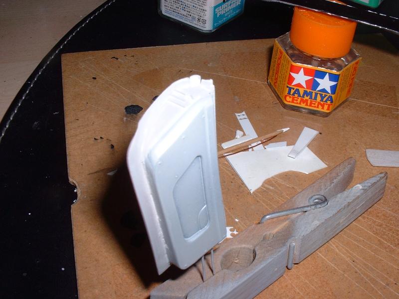

here we go:
now is time to give correct shape to the fornt of this geetee2,to do this I used 0.75mm plasticard sheet styrene nearly for all, and also cuted the door line cause the gt2 has a different wheel arch in the front end.
The main body remains the standard one (so dunno why many producers made a wider body in the rear part...doh).

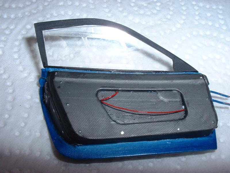

Also think will be cool to open a door (driver side) to show the cockpit when the model will be finished.
It is really too better work on very thin plastics as Fujimi one, much better than work over diecast (as BMW) where u can only have a curbside model.
The gt2 also has 2 little holes near the front lights,they should be extra air intake for brakes.The duct were made in palstic (I took theme from the thin plastics u find in kid drinks)

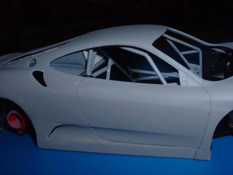

the rear part of the gt2 has different lower extractor and also both the exhausts arrive in a different point than the Challenge version.
To do this I cutted all the lower part of the chassis and remade the extractor with some aluminium coming from a can.The grille hiding the exhaust was coming from a remaining part, not a PE cause they are mostly bidimensional, and I wanted something little more 3d for this effect.
The lateral air intakes (with grilles) have a different shape, and look bigger in size.
With some tamiya rod I also build the engine part of the roll cage, also here, different from street versions.
After some finishing work on the front end we are ready for the first coat of grey primer...

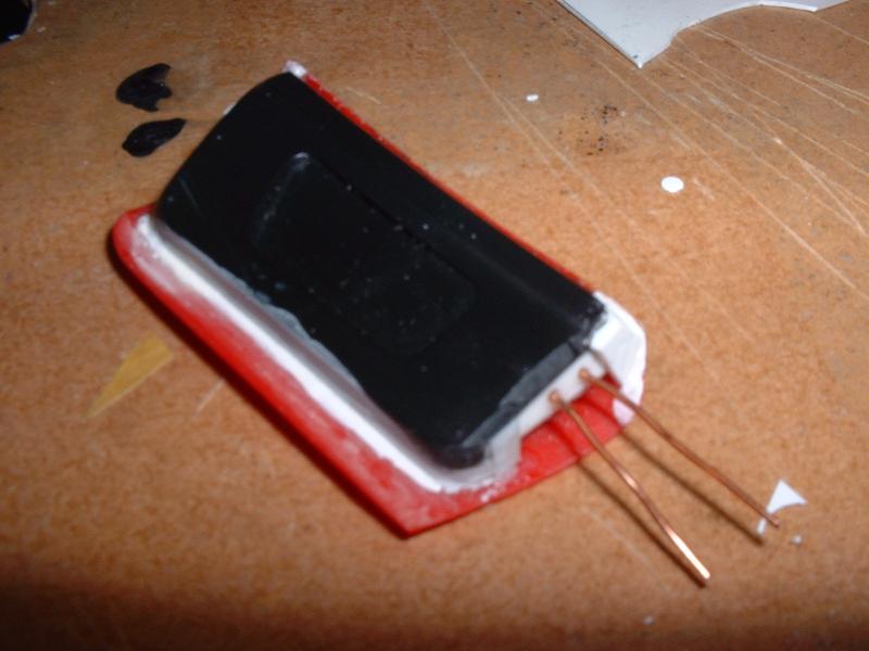

The next step is try to remould the main rear wing.Even from that scrapped 956 I took the main wing (u still can read the Rothmans letters on it), and shortened it to the correct size.The biggest problem here was to give the correct S section to its front.
To do this I cutted the last part and heated a little the plastic, refixing it 2 mm lower for each side,using super glue and some milliput.
Then I start also to fix the differences between the Challenge's roll cage shape and the FIA GT2 spec ones.Those last are quite bigger and have 2 big X tube to protect the doors side. All was redone using my beloved Evergreen sheet styrene (they shall give an Oscar to Evergreen.Without such, nearly no way to modelling for me :cwm27:)

Another part is to make the exhaust under the rear grille, I did it with Evergreen tubes.The final is an alu tube coming from Minimeca stuff (btw..what happened to Minimeca espana? it was a very great company doing a lot of metal accessories for tanks an airplanes..)
Time is up for a general fitting test for all this stuff (roll cage, body, rear part).
The look is convincing me, soon is time to add some paint..

lovegt40
02-09-2010, 11:20 AM
The decal test was done as I told before with bare metal decal film.My hope was the yellow and whites can cover the blue, but later on we will see the problems I found during decal application.
Another VERY big problem was to find the correct wheels for this car, and here I really give it up, cause didnt find at the time nothing identical to the real rims used by the gt2.
I took theme from a toycar, the look was similar to the BBS used, even if the rear wheel has a different rim.
Tested also the Sakatsu BBS alu wheels but they are flat, so wrong for wrong I choosed to save theme for a future project (I have a real feticism for BBS wheels, also in reality.. LOL).

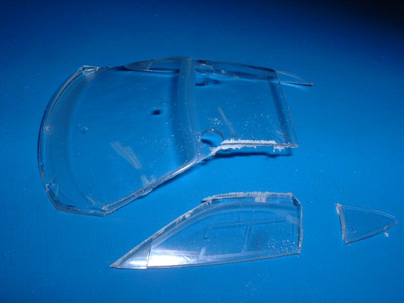

Also now is time to cut the side window and test the fitting of the trasparent parts. Sometimes they are a problem in fujimi kits, thanks God these are new mouldings, much more precise than older ones.
I also rebuild part of the internal door side, starting from kit part, and recreating a door hinge to fix it to the finished model.
http://www.modellismo.net/forum/attachments/statico-work-progress/42773d1237630266-auto-f430-gt2-lm-af-corse-1-24-188.jpg
http://www.modellismo.net/forum/attachments/statico-work-progress/42777d1237630266-auto-f430-gt2-lm-af-corse-1-24-192.jpghttp://
http://www.modellismo.net/forum/attachments/statico-work-progress/42781d1237630353-auto-f430-gt2-lm-af-corse-1-24-196.jpg
http://www.modellismo.net/forum/attachments/statico-work-progress/43021d1237890857-auto-f430-gt2-lm-af-corse-1-24-200.jpg
http://www.modellismo.net/forum/attachments/statico-work-progress/43027d1237890857-auto-f430-gt2-lm-af-corse-1-24-210.jpg
http://www.modellismo.net/forum/attachments/statico-work-progress/43029d1237890857-auto-f430-gt2-lm-af-corse-1-24-213.jpg
http://www.modellismo.net/forum/attachments/statico-work-progress/43028d1237890857-auto-f430-gt2-lm-af-corse-1-24-212.jpg

Time to start work the cockpit.
I found some nice pics giving me inspiration:
http://www.modellismo.net/forum/attachments/statico-work-progress/44950d1239888645-auto-f430-gt2-lm-af-corse-1-24-277.jpg
I gave to the interior a base with flat alluminium,also to engine bay.Preparing the color also made a metallic mixture with silver and gunmetal to obtain the correct darker color for the rims.

Also the rear glass was rebuild flat without any electri system on it.

I also made the side mirrors. The gt2 has special ones. I took the shape starting from Revell F50 ones I saved in my spare parts box.
http://www.modellismo.net/forum/attachments/statico-work-progress/46710d1241257398-auto-f430-gt2-lm-af-corse-1-24-dscf0003.jpg
http://www.modellismo.net/forum/attachments/statico-work-progress/46713d1241257398-auto-f430-gt2-lm-af-corse-1-24-dscf0010.jpg
http://www.modellismo.net/forum/attachments/statico-work-progress/46714d1241257398-auto-f430-gt2-lm-af-corse-1-24-dscf0013.jpg
http://www.modellismo.net/forum/attachments/statico-work-progress/46715d1241257398-auto-f430-gt2-lm-af-corse-1-24-dscf0015.jpg
http://www.modellismo.net/forum/attachments/statico-work-progress/46716d1241257398-auto-f430-gt2-lm-af-corse-1-24-dscf0017.jpg
http://www.modellismo.net/forum/attachments/statico-work-progress/46717d1241257398-auto-f430-gt2-lm-af-corse-1-24-dscf0020.jpg

here enclosed are now the picccies of the finished model :smooch:
Not red, but even a special ferrari not available around.
http://www.modellismo.net/forum/attachments/statico-work-progress/47004d1241532691-auto-f430-gt2-lm-af-corse-1-24-pronti-ettre.jpg
http://www.modellismo.net/forum/attachments/statico-work-progress/47067d1241615209-auto-f430-gt2-lm-af-corse-1-24-dscf0003.jpg
http://www.modellismo.net/forum/attachments/statico-work-progress/47068d1241615209-auto-f430-gt2-lm-af-corse-1-24-dscf0004.jpg
http://www.modellismo.net/forum/attachments/statico-work-progress/47070d1241615209-auto-f430-gt2-lm-af-corse-1-24-dscf0006.jpg
http://www.modellismo.net/forum/attachments/statico-work-progress/47071d1241615209-auto-f430-gt2-lm-af-corse-1-24-dscf0007.jpg
http://www.modellismo.net/forum/attachments/statico-work-progress/47074d1241615209-auto-f430-gt2-lm-af-corse-1-24-dscf0013.jpg
http://www.modellismo.net/forum/attachments/statico-work-progress/47075d1241615209-auto-f430-gt2-lm-af-corse-1-24-dscf0014.jpg
http://www.modellismo.net/forum/attachments/statico-work-progress/47076d1241615209-auto-f430-gt2-lm-af-corse-1-24-dscf0015.jpg
http://www.modellismo.net/forum/attachments/statico-work-progress/47077d1241615453-auto-f430-gt2-lm-af-corse-1-24-dscf0016.jpg
http://www.modellismo.net/forum/attachments/statico-work-progress/47078d1241615453-auto-f430-gt2-lm-af-corse-1-24-dscf0017.jpg
:runaround:
I will try a new tecknic for the BMW in the other thread, need some long tubes also there inside...

dieteufel
02-27-2010, 02:08 AM
Hi Paolo!
A very fast bull ! I like it !:naughty:
Thanx for your report!
Sascha

quick question.. I will be making an opening door on another model and I was just looking at how you made yours open. did you just stick 2 pegs in the door and 2 holes in the side slightly bigger so it can pivot? any help would be nice.
GREAT GREAT build btw. it's gorgeous
lovegt40
03-01-2010, 11:45 AM
thank u all guys.
As I told at the beginning this was a model I made last year, thats why it come together soo fast..LOL.
It took nearly 2 months to finish it.I am anyway a quick modeller, yes,cause build model for customers so have to respect the dates of delivery.
for wolf:
yes, I did it that way.
Surely it also depends from a model to another. In this ferrari doors are low and small, surely with bigger doors u have to plan it a little different.
the door trick is anyway cool and very very easy to do..isnt it? :icon16:
for wolf:
