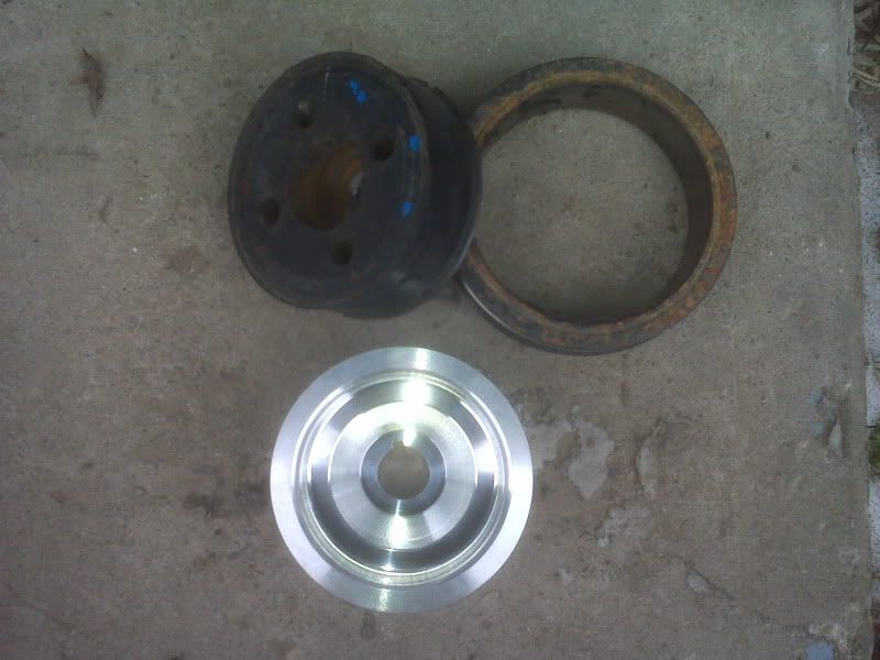

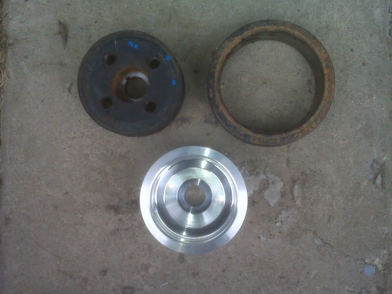

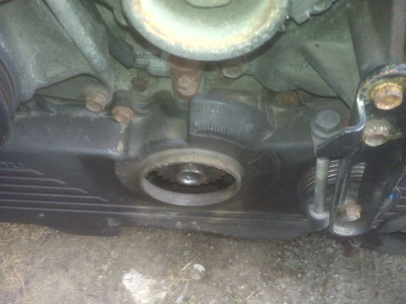

Alright, got the pulley yesterday and started pulling stuff apart today. Took about 30 minutes to get the thing out. The bolt was so tight that when I tried loosening it, the engine would rotate so I couldn't get it loose. So I took a breaker bar and pushed it against the frame and had my wife turn the engine over to get it loose. Worked perfect. Got the pulley out and as you can see, the old one is now in 2 pieces (de-lamination). Couple pics, and I'm off to get some belts.

david-b
02-09-2010, 10:16 AM
Looks good so far. Looks like a lot of space to work in there.
PS I love the breaker bar against the frame idea. I did that to the Grand Am the first time. Works like a freakin charm. When I watched the YouTube videos of that I was kind of afraid to do it, but it's great! Sadly I forgot to do that BEFORE I started pulling everything off of the motor so had to put a lot back together just to crank it.

ned032002
02-09-2010, 11:20 AM
I was worried the motor turned the other way and my breaker bar might swing full force towards the other side of the car. That my concern but I was confident enough to say I was good to go and it worked great.

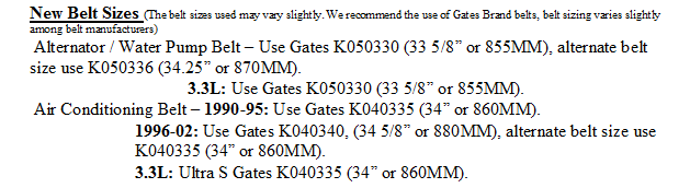

This shouldn't have been a problem because they included the new belt sizes but it was really confusing what I needed. The P/S and Alt. run off one belt and the A/C runs of it's own belt. Here's what they sent with it
http://i28.photobucket.com/albums/c208/ned032002/Capture.png
What ones would you buy?
I bought the k050336 and the k040340, the 5 groove one is the wrong one I bought.

david-b
02-09-2010, 08:36 PM
String, wrap, measure, compare

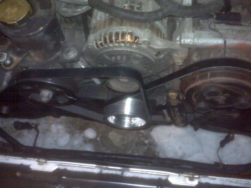

ned032002
02-10-2010, 10:51 PM
Well here she is installed with the correct belts
http://i28.photobucket.com/albums/c208/ned032002/IMG00250.jpg
Starts and runs fine. Haven't taken it for a drive yet because my fingers were numb. Thanks for all your guys help.

david-b
02-11-2010, 08:51 AM
Looks good. I was also told when installing a UDP (lightweight aftermarket one) to unhook the battery for a little bit and let the car reset itself. This way it's supposed to see there's less of a load on the crank and adjust accordingly. That's where more more will start kicking in. Not sure how true it was, but when I first did my UDP it had a little kick after the reset.
