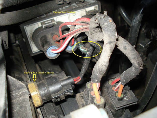

Well I don't think it is the thermo switch. There are some exposed wires that were touching each other and even a little sparks and flames when I connected the battery back up.
http://lh6.ggpht.com/_Jht9Q00CZg0/S2mmrRYbTxI/AAAAAAAAL5c/vsBHDtghKKw/s640/VW%20fan%20problem.jpg
The thermo switch might be bad because of the shorts but first I'm going to get everything seperated, fix any bad wires and then see what happens.

Ok....got the wires fixed and still had the problems so I replaced the thermo switch and that fixed it....although not right away. When I first plugged in the new switch was still the same problem. So I started to investigate how the switches worked by heating them up and checking the resistance and comparing the two. After heating up the new one I heard it 'click' . Plugged it back in and it fixed the problem. So I'm not totally convinced it is a good one.
@dav97236 - I will be watching for the problem you described. But my working theory is some battery acid leaked down onto the wires and ate away at the affected wires. We bought the car used an I cant tell the battery has been replaced a few times.

Yes that sounds quite possible. Looking at the picture it does not look as if the wires were rubbing together so it could of been acid eating the wire covering. Not a very good idea locating any control module under battery tray but, this car was designed in Germany , built in Mexico, for Americans to drive. lol . Remember the thermistor changes resistance, the hotter it gets the less resistance allowing current to flow turning on the fans so checking it against the bad one may not give a logical result. These are not bad cars they just all have the same typical problems and once fixed they go for a long time. I bought a 1999 beetle for a commuter car 6 months ago fixed all these problems and it's runs great and is very reliable still at 177,000 miles. Saves me about $75 week in gas over my expedition. good luck
