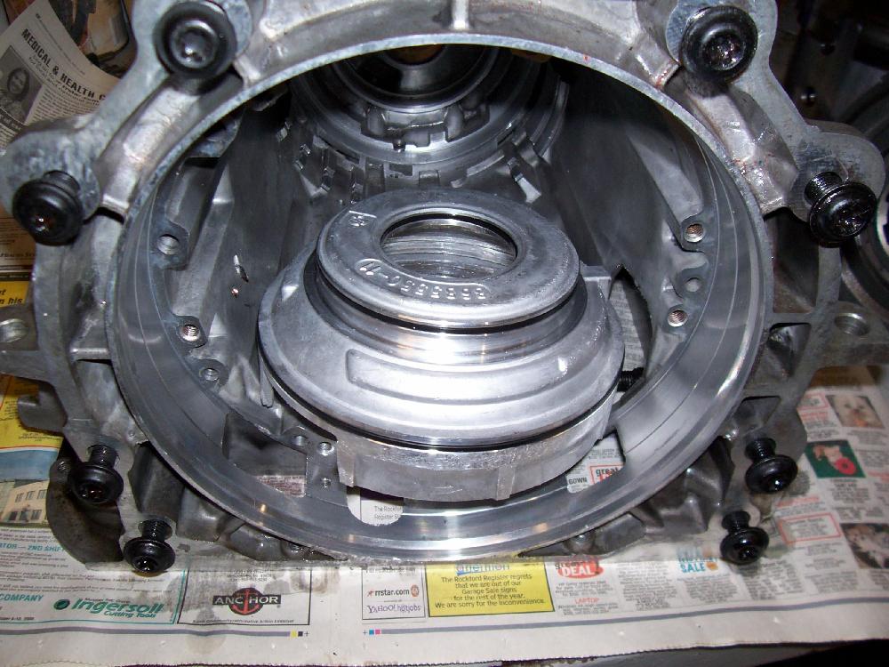

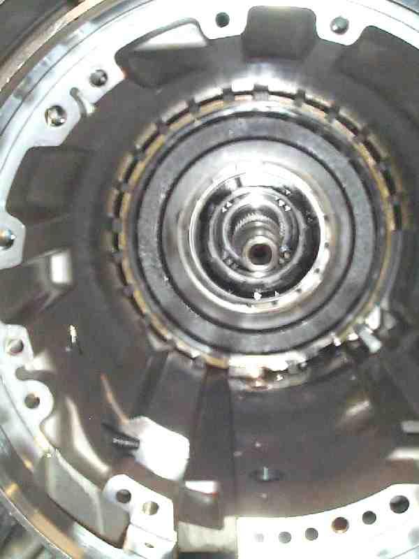

If none of the ranges operate, you may want to check the easy things such as linkage, fluid level, whether the engine is running the trans, transfer case, et cetera.
If only reverse is inoperative, there may be a problem with a shift solenoid circuit (including the main trans connector and internal harness), other valve body spool problem, lost reverse check ball (separator plate),
http://www.wwdsltd.com/4L60/4L60EValveBodyUpperBallLg.jpg
failing reverse apply piston,
http://www.wwdsltd.com/files/4L60EReverseApplyPiston.jpg
rear planetary sprag slippage,
http://www.wwdsltd.com/files/4L60EReverseSupport.jpg
or other mechanical failure. The last 4L60 I had which "suddenly" lost reverse had a rear sun gear problem.
http://www.wwdsltd.com/files/4L60ERearPlanetaryFailure.jpg
