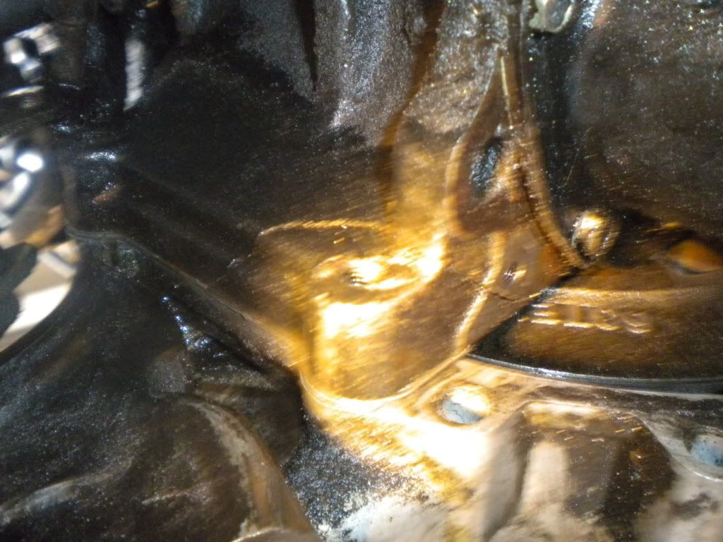

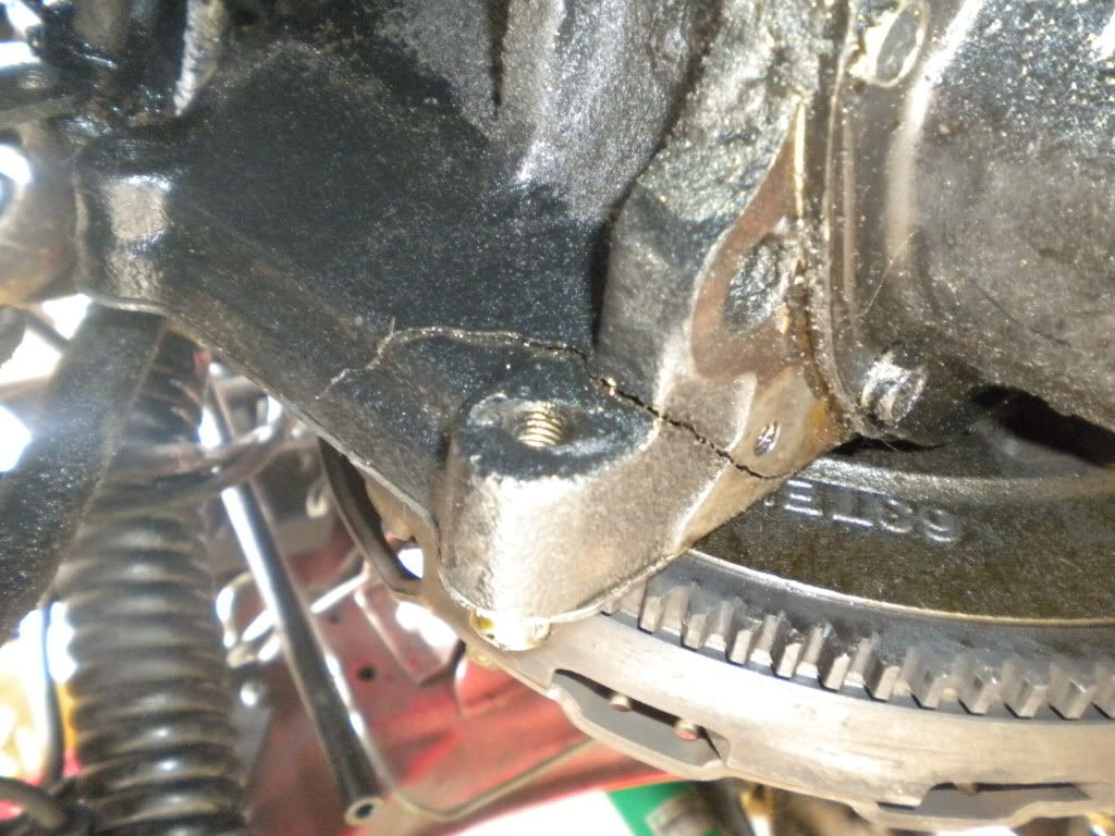

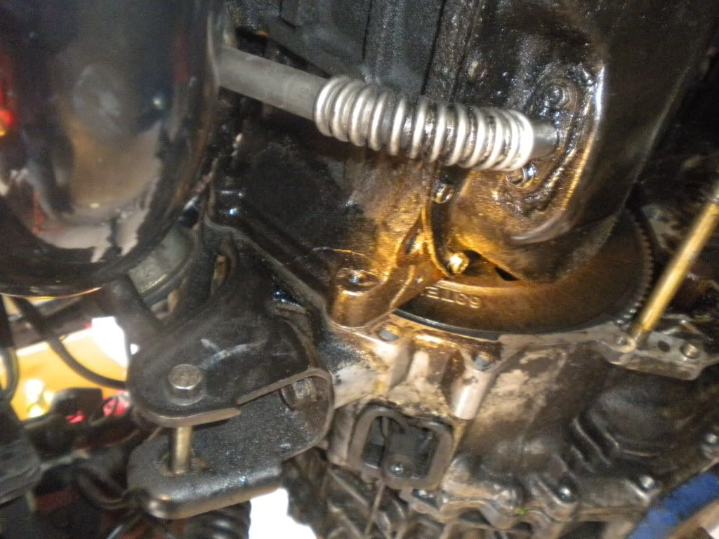

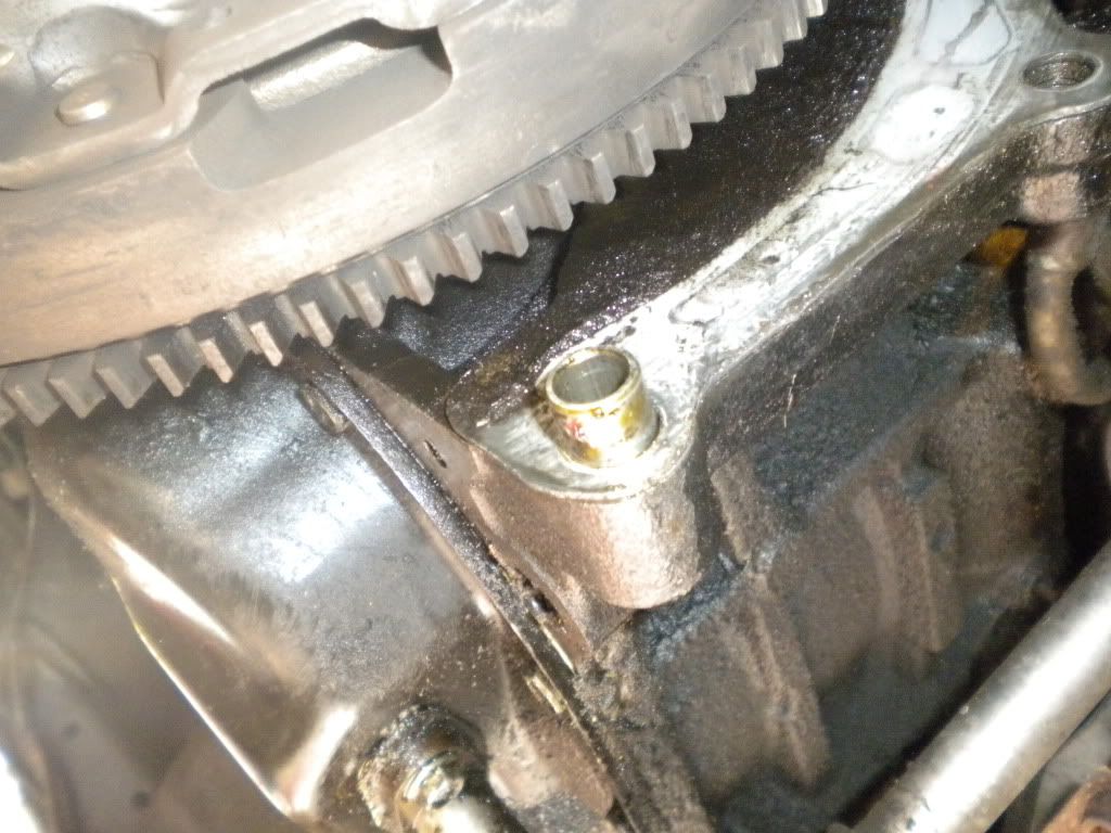

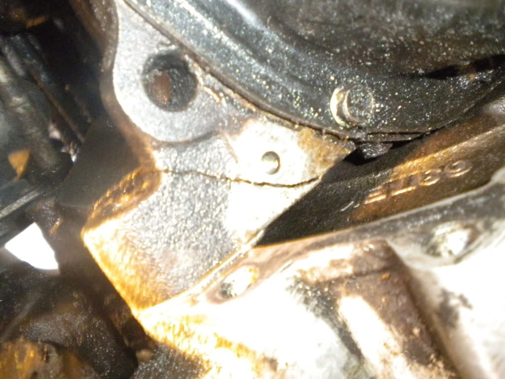

Ya I got it out this morning. One small detail the book forgets to mention is that you have to remove the transfer case, not really an important detail or anything. So the trans mission is out but I might have a bigger problem. I dont know if these pictures are going to post properly but ill post a link directly to the facebook album. The block is cracked in that corner. It wasnt a problem while ive been driving it, the bellhousing was filled with gunk. Could I JB weld this or is my engine trash?

david-b
01-16-2010, 04:58 PM
Hmmm that's not good. Not sure what can be done with that. I almost bought a block with a broken part like that and I was told it could be welded, but not sure how well it would hold up.
SilvrEclipse
01-16-2010, 08:50 PM
That block is trash. Like you said tho the car drove fine so if you really cant afford another one right now I would put it back in and just baby the car around. At least it is driveable and wouldn't just be sitting there. It could probably be welded but it wouldn't be strong at all.
cantgo2fast
01-17-2010, 11:29 PM
Well I might just weld it up and continue my plan of upgrading the engine until something truly catastrophic happens and then do the motor. I mean if its lasted this long, including a day at the drag strip this summer it might be fine forever who knows. The only way I can think to pay for this now is either some rich stranger is feeling very generous; or I take out a student loan. but if i do that im just going to take out enough and finish the thing and have the car i always dreamed of.

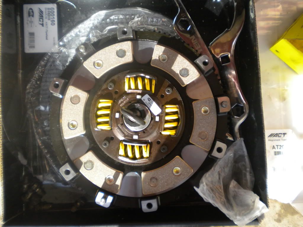

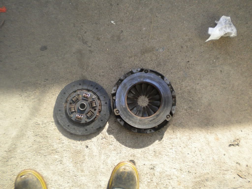

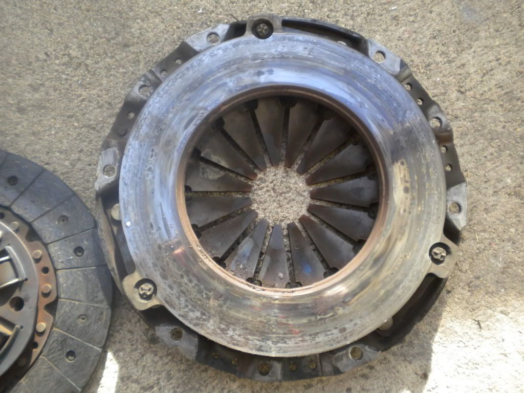

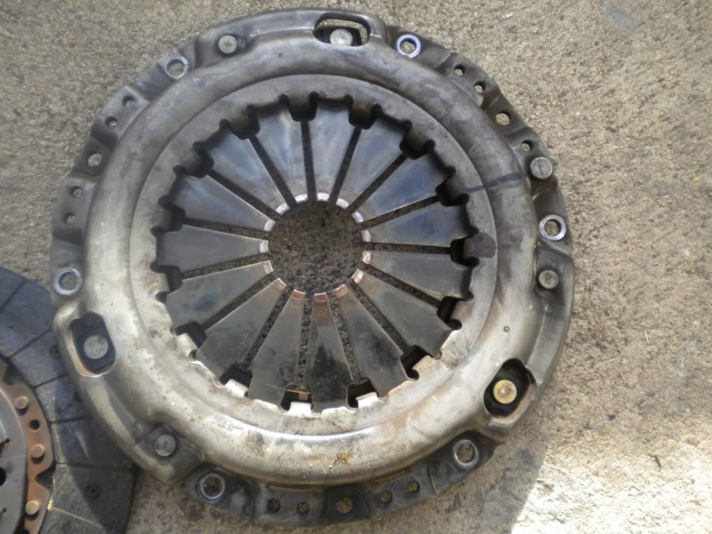

But on another note here are the old parts coming out. it looks like some one took a torch to my pressure plate, definitely time for new one. And the new parts going in :) and the coilovers those wrenches are for are in too.

vanilla gorilla
01-18-2010, 12:15 AM
Looks like that clutch has been slipping pretty good.

An update: I found A decent solution short of a new block. Its and advanced two part poly... Fancy glue. But you can only buy it by the kilogram and its $200 + Shipping for the stuff. As I looked into it Welding is actually a horrible option because in order for cast iron to be welded properly the whole area has to be heated to 900-1000 degress. Welding can actually change the molecular structure of the iron and will be more likely to crack in the future.
Since I dont have 200 dollars either its getting ghetto rigged with JB weld. Ill try to get pics tonight of the finished product. I dont have a camera so I could show you guys the prep work and such. But It survived a track day this summer with it cracked off so something has to be an improvement right?

kjewer1
02-06-2010, 11:01 PM
We had a block crack in the same place. Took it to a welding shop that is experienced in welding cast iron, and they fixed it up nice. It's still in service 6 years later. Nothing besides proper welding will hold. BTW, the block probably cracked initially because some of the trans to motor bolts backed out at some point in the past. The clutch puts enough force on the trans-block to crack those ears right off.
