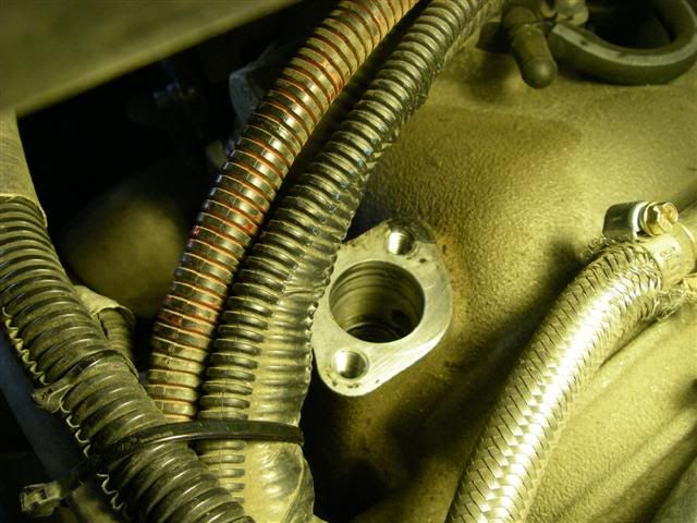

01-28-2010, 11:50 AM
Out of curiousity, if the PCV valve is completely sealed off by the two-bolted plate above it, why would the o-ring make a difference? Where could a leak come from on the top side of the o-ring? (I'm not disagreeing with you at all, it's just the PCV on these cars has never made sense to me because it doesn't flow or open to anywhere but the sealed chamber it sits in....)
:dunno:
Weird PCV setup but it works and is needed. Did you miss the small hole going back in to the intake (supercharger) so it is not completely sealed off? See pic.
Or try running without the PCV installed and let us know the results. :biggrin:

You have GOT to be kidding me!! I had NO CLUE that little hole was in there!! Now do you see why I was so confused?? :rofl: It all comes together, the planets align! I seriously thought you guys were all a bunch of crack heads thinking that PCV valve did anything, but yes, that hole there changes everything. Every time I've opened that plate I'm always approaching from the driver's side so I've never seen that. Unbelievable. :runaround: It is a weird set-up, yes, but at least now I can conceivably understand how the thing works in there.

Have you ever replaced the PCV valve? Check the condition of it and the o-ring seal to start. And check the vacuum lines at the MAP sensor and off the supercharger and throttle body.
Guess what? I was working on the cars Saturday and found a crack in a vacuum line. :disappoin I think Bob snuck up and put a slit in it so that he could say, "told ya so." :p
I took a pic of what the hose connected to but will have to post it later once it gets sent from my phone.
00GTP4ME
02-01-2010, 11:46 AM
Ok, here's the pic. You can't see the leak in this pic, but I took a picture of where the leaky hose plugged in. I highlighted it in red...
Does anyone know what that is or what it's going to? (sorry for the crappy phone pic)...
