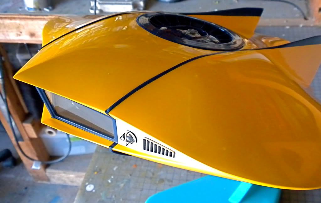

This is the first time I’ve buffed out a finish to this extent, and I’m pretty pleased with the results (for the record, this is Moebius Models’ kit of the Flying Sub from the old Voyage to the Bottom of the Sea TV series).
I used Tamiya rattle-can lacquers finished off with polishing abrasives. I’d originally planned to topcoat with clear, but the polished yellow looked fine without it.

That looks fantastic. The finish is spectacular. Some of those Tamiya colors really don't need any clear to come out that beautifully. I'd like to know how much paint you used (approximate number of heavy coats) and how much effort you put into polishing it.

Awesome! There will be more than a few around here who would be more than happy with that fantastic finish you have achieved :thumbsup:
Maybe it's just the photo lighting but a couple of the parts - such as the hatch in the bottom - look as if a light was would help add some depth and definition to the parts.
I went through seven (or was it eight?) cans of Tamiya Chrome yellow.
Basically, I applied several light mist coats, building up a heavy wet coat. After letting the finish cure for a couple weeks I sanded out a couple glitches, then repeated the process.
So, I suppose the answer to your question is two heavy coats.
Once the surface was fully cured I started in with Micro-Mark polishing abrasives, beginning with 3200 and working my way up to 12000.
Photography is not my forte lol, but I really need to take some better shots of this thing. That hatch was given the turpenoid & dark blue-grey oil treatment to bring out the recessed areas, but it’s just not showing up in the pix I took.
