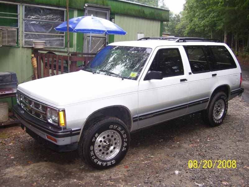

As for the grounds... They're in a different spot because someone else put another motor in this when I first bought it. Only reason I got it for so cheap is beacue they left the ground loose and it was running like total sh*t. I tightened the ground bolt and it's been running like a champ for nearly two years until this problem!
Here's what it looked like when I first bought it:
http://i2.photobucket.com/albums/y37/indeepshitnow/100_6800.jpg
Not bad for being 15 years old back then! Anyhow, I appreciate your input on my issue... I'll be buying a Delphi in a couple of weeks. That is, after I make sure the pulsator does not need replacing first.
