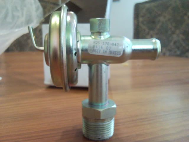

i picked up a heater valve for my 87 307 caprice classic wagon. the one in the car is different though. the new one has a threaded inlet on the top and the old one doesn't. however it doesn't seem like the inlet is even usuable or passes air/fluid. no picture i find shows the part like the old one in the car now. any ideas or knowledge on this?

http://i63.photobucket.com/albums/h151/livewire1568/Mobile%20Uploads/SNC00090.jpg

that looks like the correct part except for the small nut fitting looking on the top of the valve. if this is sealed up this may have been designed and modified to be used with this open in another application..
test before installing. hook up to a hose with water and see if it opens the valve when heat is on..using a vacuum line to the new valve..

i don't know for sure what it was for but it worked. we actually used it to screw it back on. maybe that was it's purpose??
