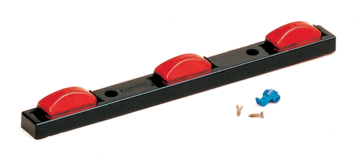

For many vehicles, I feel they lack enough rear factory lighting. Especially the Montana / Uplander van while being used on dark night country roads. Thus, I installed extra rear "center lighting" on my '09 Montan EWB van.

If wondering, inner single lights are marker/clearance lights. The outer lights are combined brake/signal lights. All lights are connected into factory tail lights using T-Connector. Red lenses are water proof and are DOT stamped. When following my wife's van at night, its extra rear lighting looks great. Well worth the time / effort for this customization. Especially while driving in my region's dark country roads.
If you don't have a trailer hitch system on your van, install standard 3 light ID bar for its center lights instead. Same ID bar that's installed on trailer's wider then 80" re: http://www.marineengine.com/products/images/2770093C.jpg
If you feel more rear lighting is needed on your van, do "clone the above".
