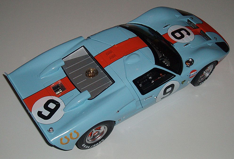

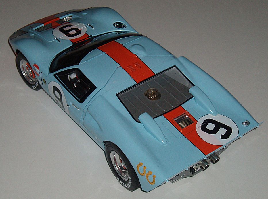

Any kind of inkjet printer will be fine.
White decal paper will give dense, bright decals but you will need a colour background behind text.
Log's, badges, etc work a treat.
Clear coat with spray can Polyurethane varnish as it 'sticks' to the decal paper better than acrylic spray.
I've made my own decals for cars for years.
The Trumpeter GT40 below was done with my own decals.
P.S.... I've since added a 'second layer' of number roundalls to hide the orange stripe beneath.
Roy.
