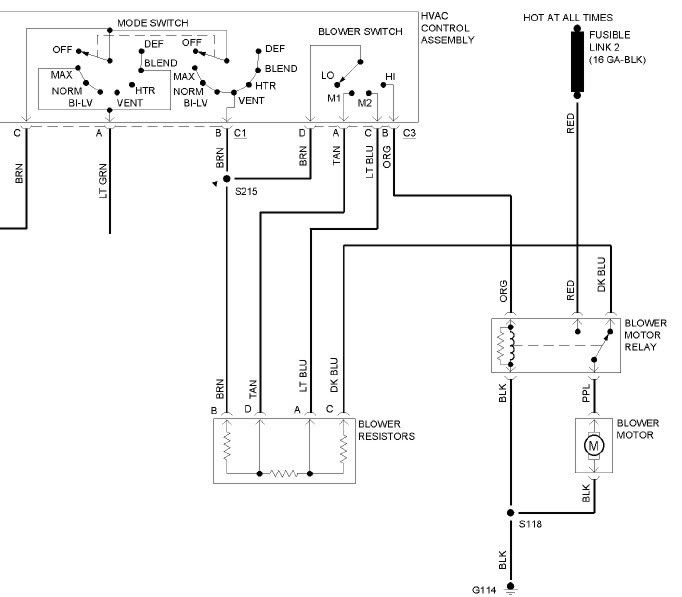

http://i83.photobucket.com/albums/j293/airjer/AF%20Stuff/97blazer.jpg
I don't know how that is possible. This is a power side controlled system. If there is power to the blower motor on the purple wire and the ground on the blower is good than the blower has to work. Did you check for power with the connector plugged in and the heater turned on? If there is increased resistance in the power supply circuit it may not show up unless there is a load (poor contacts, burnt up contacts, corrosion, almost broken wires). It might be worth pulling the control head and checking to see if the connectors are burnt up.
old_master
12-12-2009, 11:15 AM
That schematic is for manual HVAC, The climate control schematic is completely different. Alldata or a GM factory shop manual will help with diagnosis, don't waste your time or money with Haynes or Chilton.
