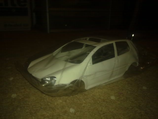

I have just recieved this through the post:
http://i253.photobucket.com/albums/hh78/indy231/07122009738.jpg
http://i253.photobucket.com/albums/hh78/indy231/07122009737.jpg
http://i253.photobucket.com/albums/hh78/indy231/07122009736.jpg

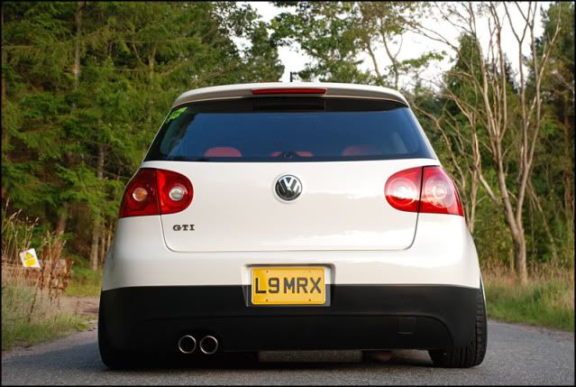

I will be basing it on a well known U.K. MK5 Golf GTI. Here is the car in question,
http://i253.photobucket.com/albums/hh78/indy231/lomax2.jpg
http://i253.photobucket.com/albums/hh78/indy231/lomax.jpg
http://i253.photobucket.com/albums/hh78/indy231/lomax3.jpg
http://i253.photobucket.com/albums/hh78/indy231/lomax4.jpg
Now for the question!
I want to remove the rear badge from the boot. It sticks out on this model. What is the best way to do this?

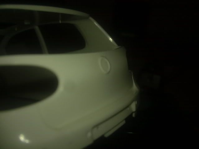

Here is the picture of the boot badge as requested.
http://i253.photobucket.com/albums/hh78/indy231/07122009739.jpg
mike@af
12-07-2009, 02:44 PM
Sanding it flush using a sanding stick should be all that's necessary.

You should be fine with just sanding for this. :)

Sanding is the best option, however if you use any hotter type paints without primer you could see "ghosting Of th shape sanded away. Even a hot primer can raise it. After sanding lightly brush liquid glue over the area it will raise it, let dry overnight than sand smooth again. It sounds odd but it does protect against "ghosting.
