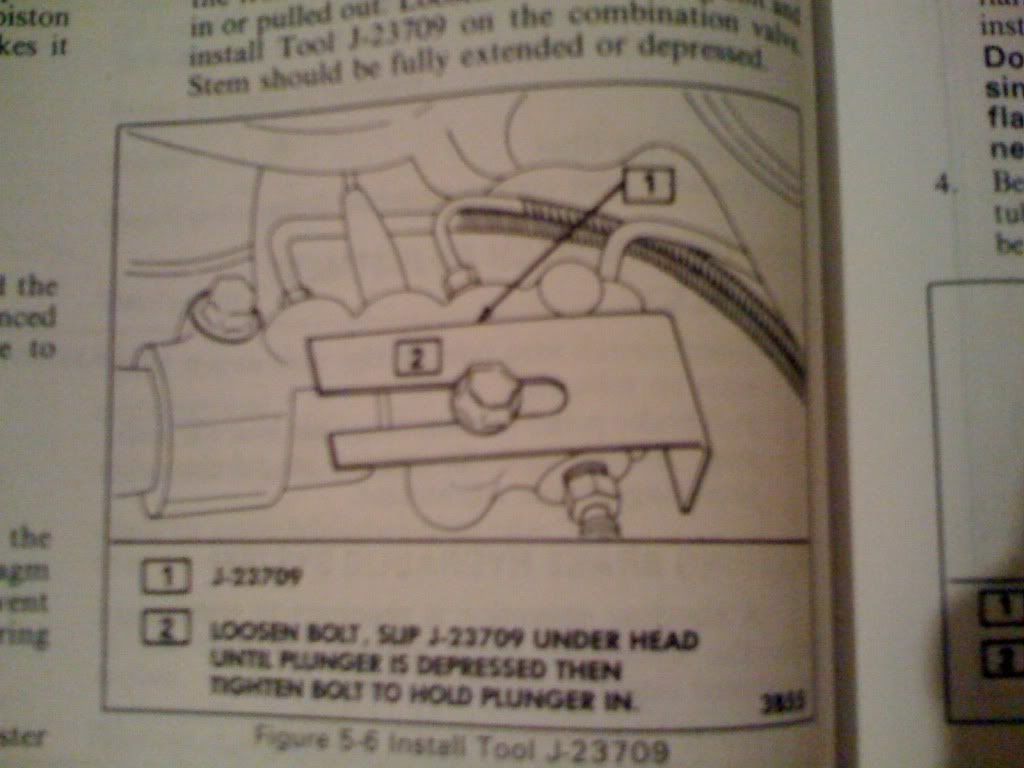

In the service manual the only thing I can find out that pin is in the "pressure bleeding" section:
http://i121.photobucket.com/albums/o219/ernestmayhand/Caprice%20resto/a39386e9.jpg
Not sure about all this.
maxwedge
11-30-2009, 09:16 AM
The button on the prop valve pulls out, for bleed ing the rear.
deesandvees
11-30-2009, 09:57 AM
Okay well it is out, is there something I need to do to push it in or does it just take some muscle?
