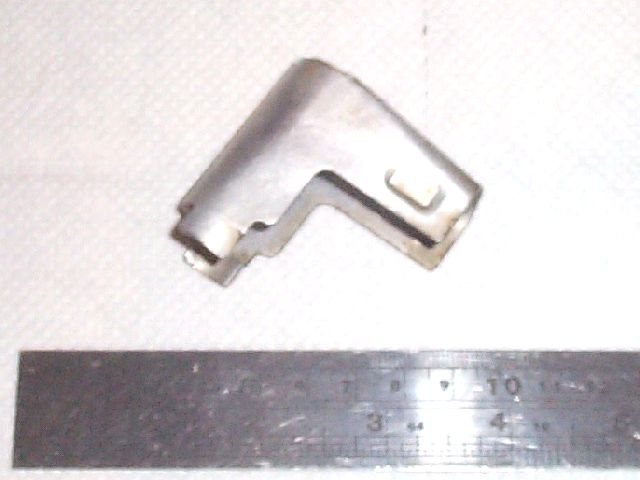

I'll agree with that. You will also want to retain the factory heat shields if at all possible:
http://www.wwdsltd.com/files/PlugShield.jpg
I've been able to change mine from the bottom and route new wires from the same place. The #2 and #4 plug wires are not a lot of fun, but it's worth the effort to do it right.
