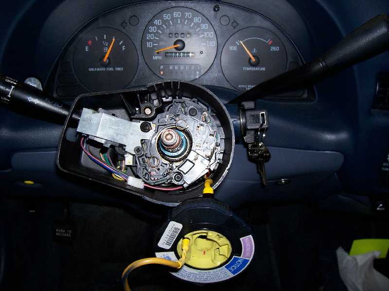

Blue Bowtie
11-26-2009, 10:09 AM
You could try to search the board archives. There are plenty of threads here addressing that very issue. Changing the multifunction switch is not difficult, just time consuming. The instructions are readily available, and the part is usually about $50.
http://www.wwdsltd.com/files/W-BodyTurnSignalSwitchExposed.jpg
http://www.wwdsltd.com/files/W-BodyTurnSignalSwitchRemoval.jpg
