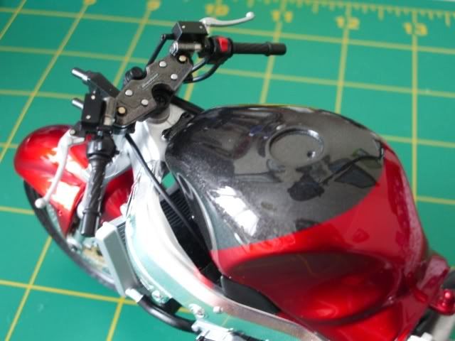

If you apply the lacquer correctly and properly thinned you should need very little polishing. However it's not always possible to get a 'perfect' finish straight from the airbrush and some polishing will be necessary... Even the best painters sometimes have to do a little polishing for the best 'orange peel' free finish.
Couple of pictures of 2K lacquer on my Tamiya Suzuki Hayabusa kit. Zero paints used for the entire painting process and no polishing needed on any of the parts.
http://i17.photobucket.com/albums/b61/stevenoble/Suzuki%20Hayabusa/Hayabusa-firstdecals008.jpg
http://i17.photobucket.com/albums/b61/stevenoble/Suzuki%20Hayabusa/Hayabusa-TankandSeatUnit031.jpg
