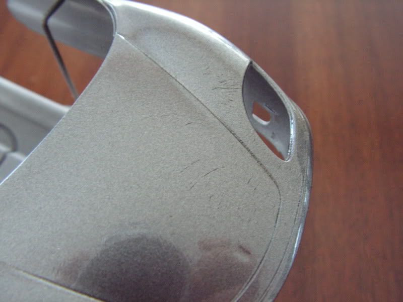

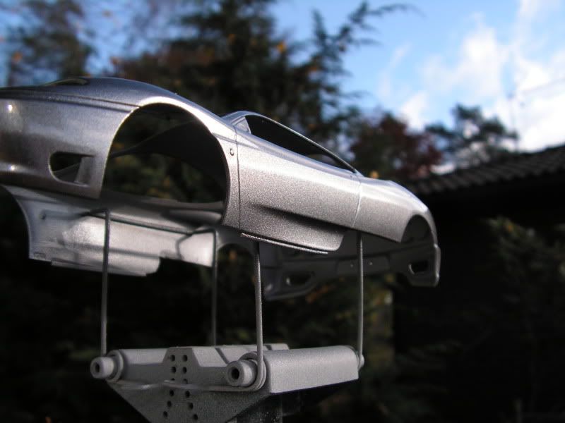

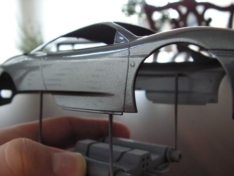

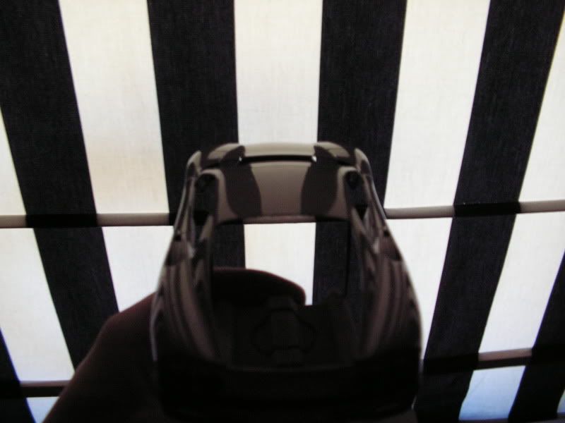

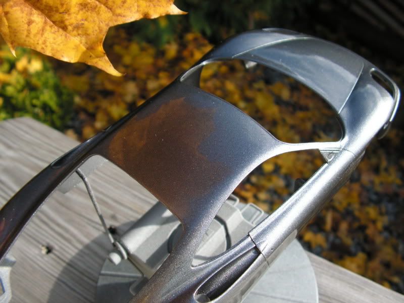

das_auto
10-29-2009, 06:37 AM
Hi Gio!

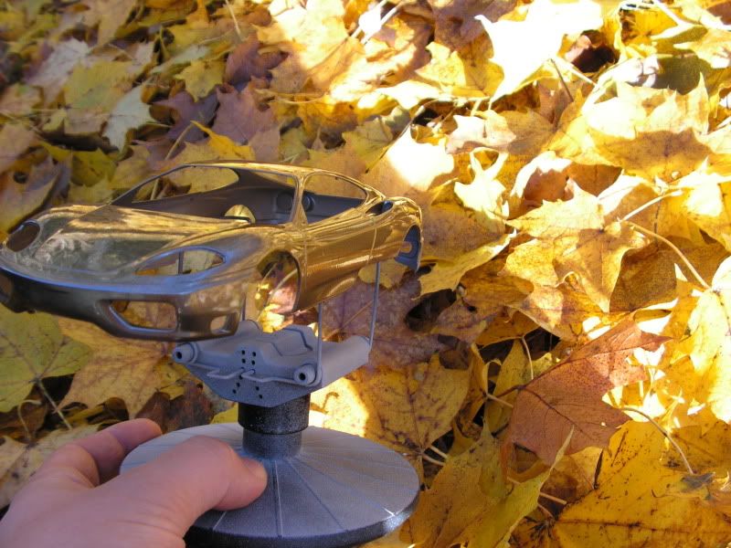

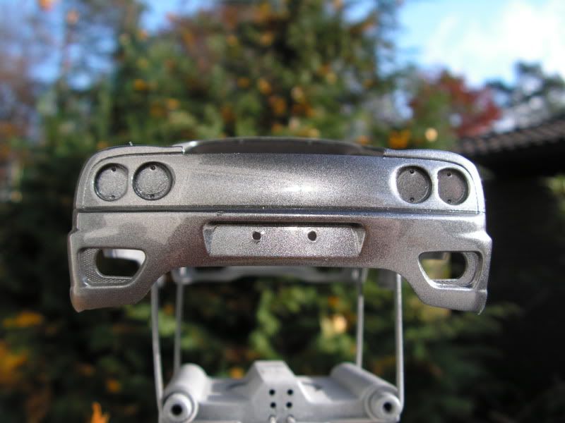

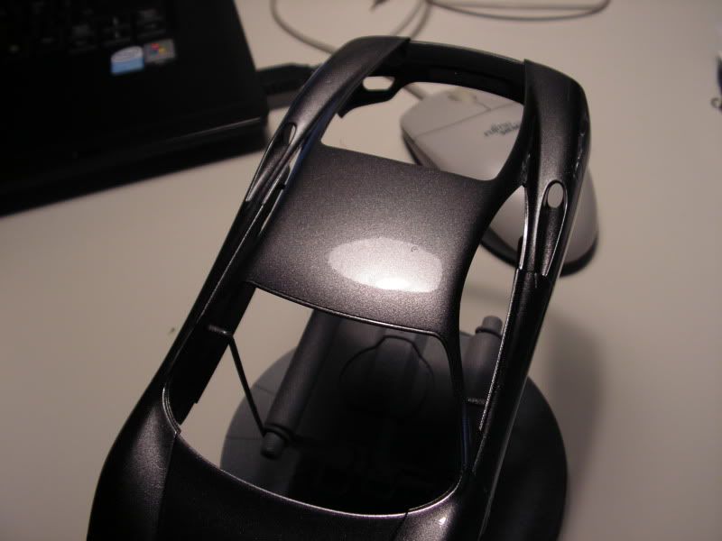

Sure, I can show you....
Just remember that Iīve just started using it and that Iīm just experimenting with techniques and pressures, dryingtimes, viscosity and so on.
On my sample Iīve tried to push the limit a bit and also experiment quite alot. The 360 modena shell was first painted with Tamiya gray and white primer from the can, then this was wetsanded with 4000 micromesh. Then I decanted some TS-38 from the spraycan and shot it onto the body with the spraygun without thinning. At about 20 psi (1 bar).
Then this was smoothed with some 8000 micromesh, cleaned and left to airdry. Then I cleared it with some Zero 1K acrylic clear (Lechler Acrifan?) this was only applied in one coat. And in hindsight that coat was a little too heavy since it made the undercoat crack a little, but thatīs why you use a test body right :biggrin:. The body is not sanded or polished after clearing.
There is some texture but not much. Next time I will leave primer and base to dry for longer, use zero products only and apply the clear in 3 coats with ample drying in between and thin the clear down a little. Maybe Iīll even use 2K because that would be so awesome and would defintiely work 10 times better. not having to worry about cracking undercoats and such, but Iīm still trying to get over my fear...haha
Well....hereīs the pics (sorry but iīm no good at photos!)
First some indoor shots...
http://i295.photobucket.com/albums/mm158/nr1forme/PICT0101.jpg
http://i295.photobucket.com/albums/mm158/nr1forme/PICT0096-1.jpg
http://i295.photobucket.com/albums/mm158/nr1forme/PICT0087.jpg
and then some autumn style outdoor ones...
http://i295.photobucket.com/albums/mm158/nr1forme/PICT0089.jpg
http://i295.photobucket.com/albums/mm158/nr1forme/PICT0090.jpg
http://i295.photobucket.com/albums/mm158/nr1forme/PICT0092-1.jpg
http://i295.photobucket.com/albums/mm158/nr1forme/PICT0098.jpg

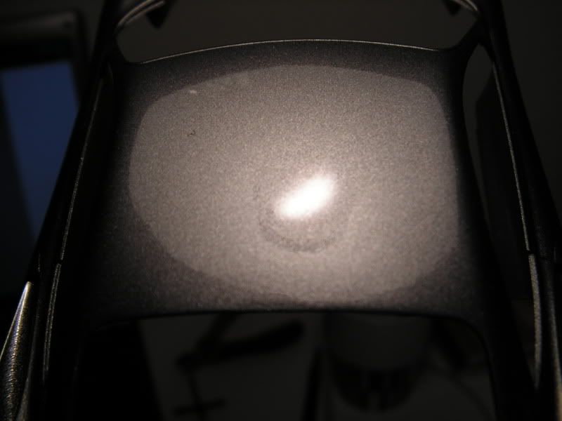

and some highlights, what happens when you take it too far and apply too much clear...
http://i295.photobucket.com/albums/mm158/nr1forme/PICT0095.jpg
http://i295.photobucket.com/albums/mm158/nr1forme/PICT0094.jpg
So, thatīs all for now! Love to hear your opinions! :biggrin:

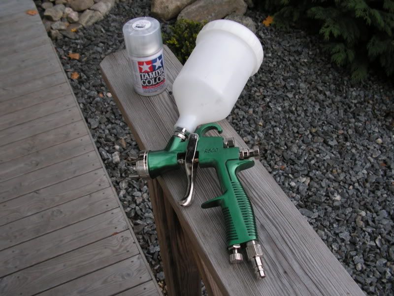

Hello
I also use automotive paints, and the guy that sells them to me is trying to convince me that I should get a spray gun, at least for the clearing.
Can you snap a picture of your gun ?
Cheers
Here you go slash! I put a Tamiya can next to it for size reference. Itīs a pretty big gun. But easy to use.
http://i295.photobucket.com/albums/mm158/nr1forme/PICT0102.jpg
Cheers!
Emil
