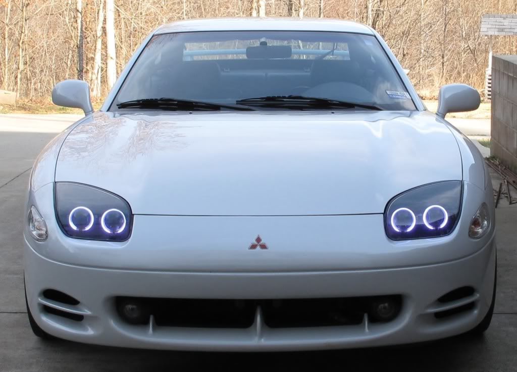

instead of doing all that, you could take a much cheaper and less time consuming approach and pop in some rx7 headlights. not exactly the same thing, but it still looks good and gets rid of the pop ups.
http://www.carstylingtips.com/wp-content/uploads/2008/12/dsc02255.jpg
http://www.carstylingtips.com/wp-content/uploads/2008/12/dsc02256.jpg

No, no and NO. Those headlights are horrible.

and I love vr4chokes' headlights what are they? The angel eyes or somthing different?

What year rx7s' fit? And what mods are required for those

No RX7 lights actually fit. Those are a kit you buy. The look like total ass IMO.

my headlights are just stock minus the snake eyes lens.
you can get those rx7 kits off ebay tho for like 600 i think

You're thinking of JOJO. He sold his car so he is no longer looking to do that. His looked 100 times better than the other ones pictured but I still wouldnt use them.

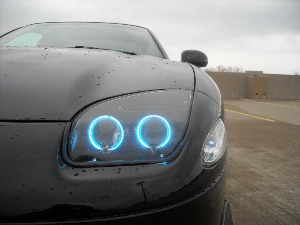

if your gonna ditch the pop-ups, but dont want to spend a fortune on TRUE '99 headlights, go with '94s and do a robo-angel-eye mod. :2cents: (will post up a pic later)

Angel eyes are what I want just without the robo mod
but i thought stealthie said I would have to change the core suport to upgrade to those
that's why I'm thinking parts car so I can grab the core support, shifter boot, dome light, door panal, wheels, tires, ect...

Will those fit my 1st gen or do I have to change the core support to make them fit the blue ones on the black car are the ones I want
Stealthee
10-15-2009, 08:04 PM
Those are robo modded glass angel eye headlights. That swap is no different than a 2g swap because it it modified stock 2g headlights.

Those rx7 headlights kind of make the car look like a Ferrari 575, in my opinion.. but then what you have is a mitsubishi which is trying to look like a ferrari, and thats not cool haha.

Attn admin: What happened to the pic of the black car is looked way better than the white one
:confused: all pics are there??
