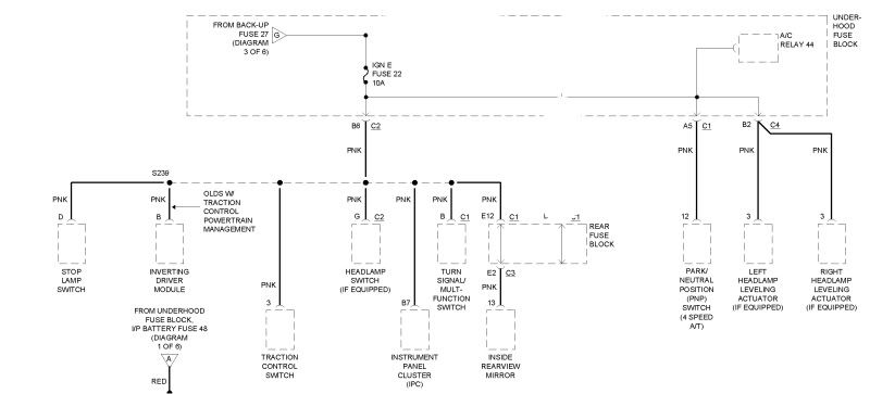

Trying unplugging all of the items that this fuse supplies power to. Than plug them back in one at a time until the fuse blows. Then focus on that item as the culprit.
http://i83.photobucket.com/albums/j293/airjer/AF%20Stuff/ignitione-1.jpg
