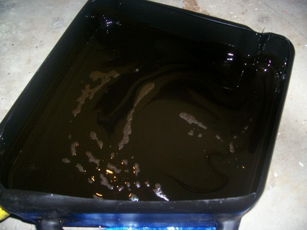

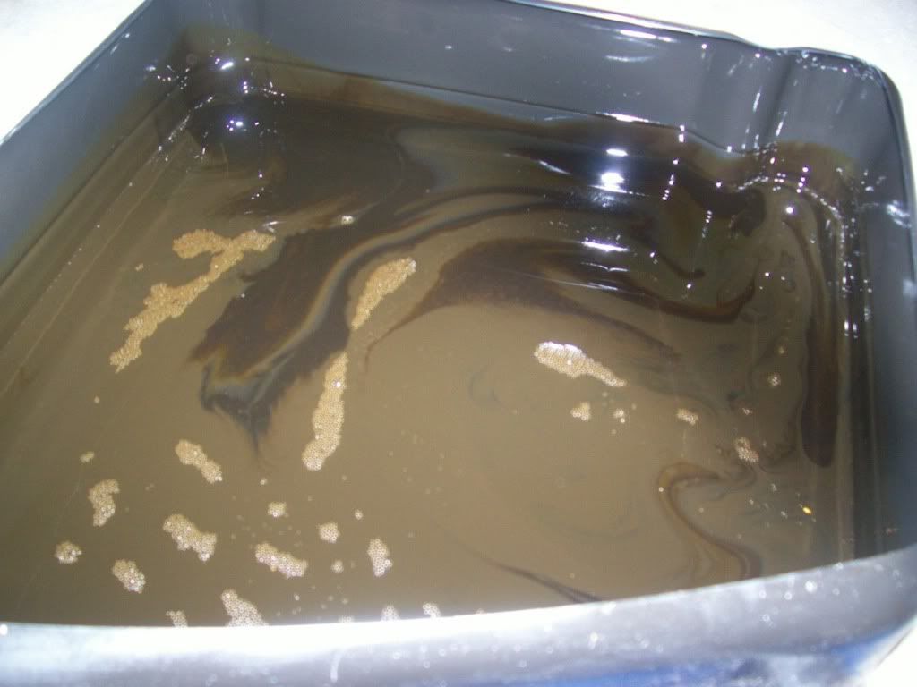

i pulled the valve cover off and the chain is broken, couldnt pull it all the way out tho. also pulled the plugs, they look like they havent been changed in awhile. now i will be trying to rotate the crank to see if i can move it and if i can i will find top dead center for the 1st cylinder and begin replacing the chain.

Pull the head,you have bent valves and it will do this on 1996 and up 2.4 quad 4s including jumping time since it is an interferance engine.

If i remember right, the 2002 4 cylinder is the quad 4 which is an interference motor. if this is so...then forget replacing the timing chain cuz the motor aint gonna run.

1996 to 2003 2.4 quad fours are interferance engines.By looking at the picture,it is the 2.2 ecotec engine,not the quad 4 which do have timing chain problems once in a while.Quad 4s do not have a valve coverThe 2.2 ecotecs are cheap to find at any auto salvage yard and easy to find,not worth fixing when the timing chain breaks also bending valves.I have replaced 2 ecotecs,timing chain broke on them and it was cheaper to replace the engine due to price of them used.There are 2 hidden bellhousing bolts,not one on the ecotecs.

thanks for the replies guys. so what does that oil tell ya. is it the head gasket or the head itself.
