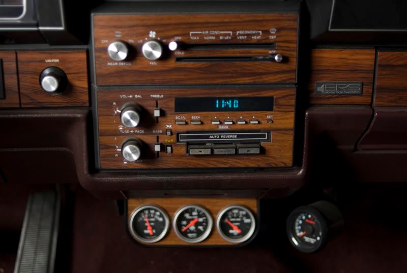

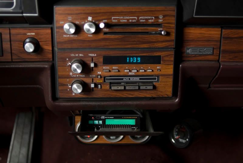

Here's what I did in my '87. I'm very very anti-cutting the dash so this is what I've found to be the best option. The unit is an Alpine Direct CD Changer Controller and can be found on eBay for anywhere from $5 to $25 (because I don't think they make anything like this anymore and it's considered "old school" which usually isn't good in the car stereo department). The whole system is the controller (seen below installed in the ashtray) and a main unit which is a box that's about 1"x4"x3" that hides nicely up behind the factory stereo. The controller has a long cable on it so it could be installed almost anywhere in the car you want, personally I prefer in the ashtray so it's easily hidden. The main unit has an auxilary input which is speaker wire so you can just run your factory stereo's speaker wires to this input and listen to your factory stereo as long as you set the controller to auxilary. The other input is for the CD Changer but Alpine makes a cable that will input and power an iPod so you can run your iPod instead of a CD changer. IMHO, it's a thing of beauty. What do you think?
