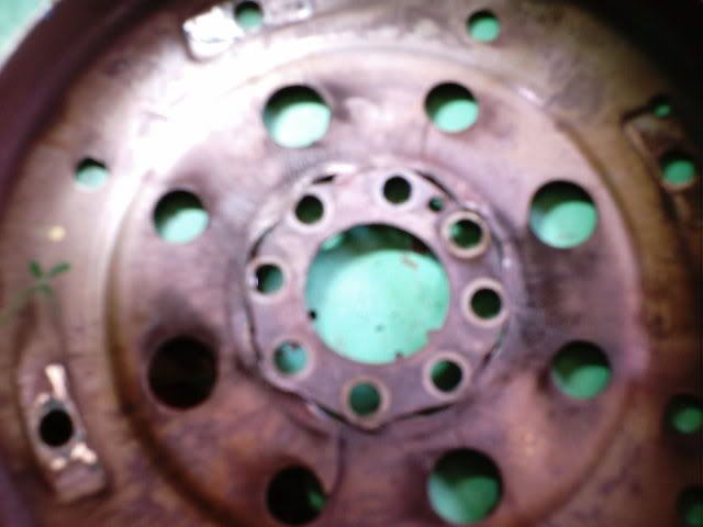

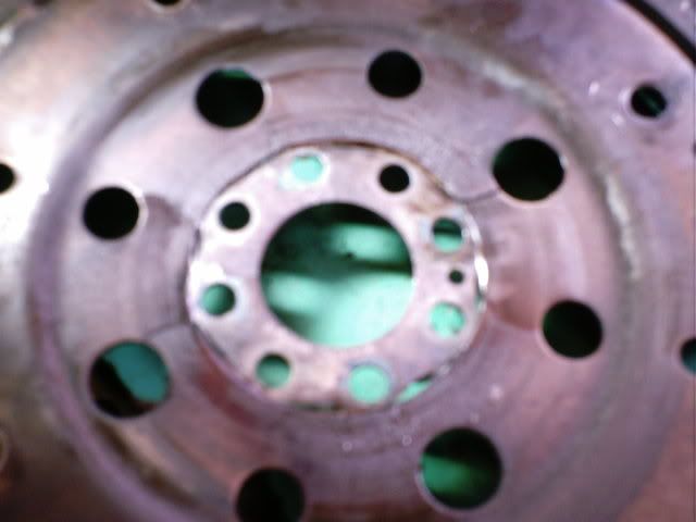

well after going a while over winter,& being busy, this van took a back burner as we had a spare vehicle, I did not have the means to drop the tranny, so I took it to a nearby shop here are some pics of what they found today.
http://i155.photobucket.com/albums/s294/russell_smith93/forum%20source%20pics/SUNP0026.jpg
http://i155.photobucket.com/albums/s294/russell_smith93/forum%20source%20pics/SUNP0024.jpg
http://i155.photobucket.com/albums/s294/russell_smith93/forum%20source%20pics/SUNP0025.jpg

Wow. A bit blurry but I can see that's one ugly flexplate. I'm wondering how it ran at all. The crankshaft signal was the culprit. The engine can run (not start) without the camshaft signal but you loose the crank signal and you're dead in the water. Lucky it didn't die out in the sticks somewhere. Thanks for coming back and posting this. It tells the whole story.
