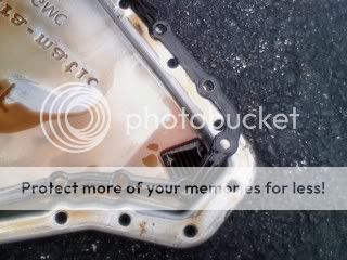

Anyway, I was surprised at how clean the pan was when I dropped it. It had almost no clutch material and the magnet barley had any metal on it. Will post pics soon. When I did the pan drop last year (20k ago) the bottom of the pan was layered in gray with clutch material. Now it makes me think that the trans fluid may never have been changed, before I did it, or it had been a long time. Seems that the max life is pretty good fluid.

Pic's
Seem like almost no clutch material except for a spec. Makes me confident in the expected trans life considering I do at least one WOT shift everyday.Fluid is dark. The first trans drop I did you couldn't see the trans pan stamp. Maybe I'll make it to 200k

I wonder if using the Dexron/Mercron Valvoline trans fluid contributed to this in either case I approve that fluid.:p
