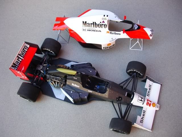

stevenoble
09-10-2009, 04:01 PM
I built mine a while ago, there's a w.i.p and completed thread if you do a search. Its difficult to replicate the exact look. I used a mixture of paint and carbon decals to try and achieve the 'bronze' colour. I also over sprayed the decals with very thin clear coat tinted with clear colours. It sort of worked. In some of the pictures it is more noticeable than others and it also depends on the way the light catches it.
The 'bronze' look is visible in this one at the front, although the rear looks grey/black in comparison
http://i17.photobucket.com/albums/b61/stevenoble/McLaren%20MP4%205B/IMGP3603.jpg
This was my favourite picture of my finished model. When you compare the 'bronze' look of the monocoque to the black of the tyres and suspension components it really seemed to have worked quite well.
http://i17.photobucket.com/albums/b61/stevenoble/McLaren%20MP4%205B/IMGP4172.jpg
