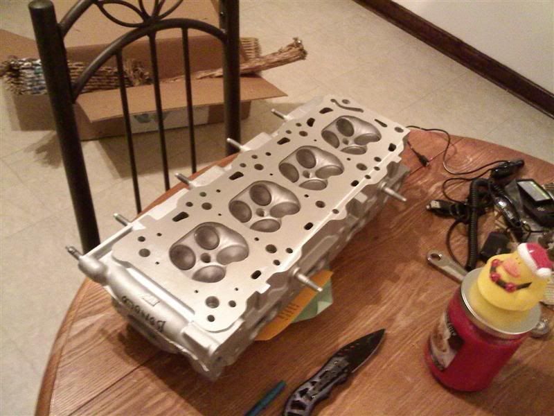

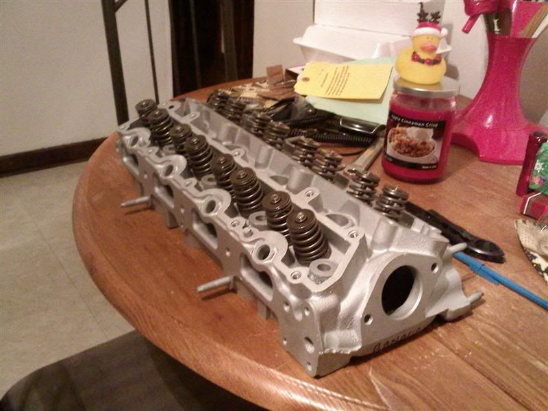

Grand Am is up and running and back in my hands. The head was warped so bought a totally rebuilt one off ebay and got it all taken care of.
He said compared to having it at his shop, I saved about $600 just on labor alone, plus the price of all the parts would have been more. Got those at cost.
The Talon will now be headed to the garage will it will be stored and worked on from time to time. And driven when the snow is melted or nearly gone. I still have lots of work left for it so it's good to be out the way and off the snow and not being used as a DD. I do want to get on the dyno for a tune and some numbers when it's still stupid cold, just to take advantage of that nice dense cold air. But now with having the DD running, Talon is going away.

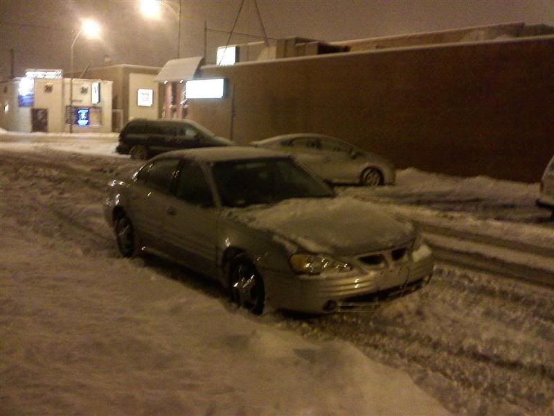

Yup been driving it since I picked it up the other day. Put over 100 miles on it just last night :) Thing has bee great. Noticing some small issues here and there with just the car in general but it's all basic fixes. I'm going to clean it up some today and try to get the passenger side mirror back on. All small stuff, but the car is filthy inside so I want to really clean it up.
Thursday night when I got her home. Notice all the crappy snow

New Head
http://i59.photobucket.com/albums/g291/david-b/0104001736Medium.jpg
http://i59.photobucket.com/albums/g291/david-b/0104001739Medium.jpg

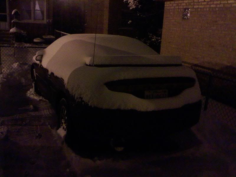

And how the Talon looked Thursday night after 8-12" of snow
http://i59.photobucket.com/albums/g291/david-b/0107002033Medium.jpg

Car got towed to my mechanics place again. He took it back and going to tear it apart this week and see what's up. Thank god for free towing. This car has seen more tow truck time in 2 months than the Talon has in 2 years.
On the upside, I got the Talon to crank today. Torched the starter and that seems to break it free. Sweetness. Sadly battery was dead though.
