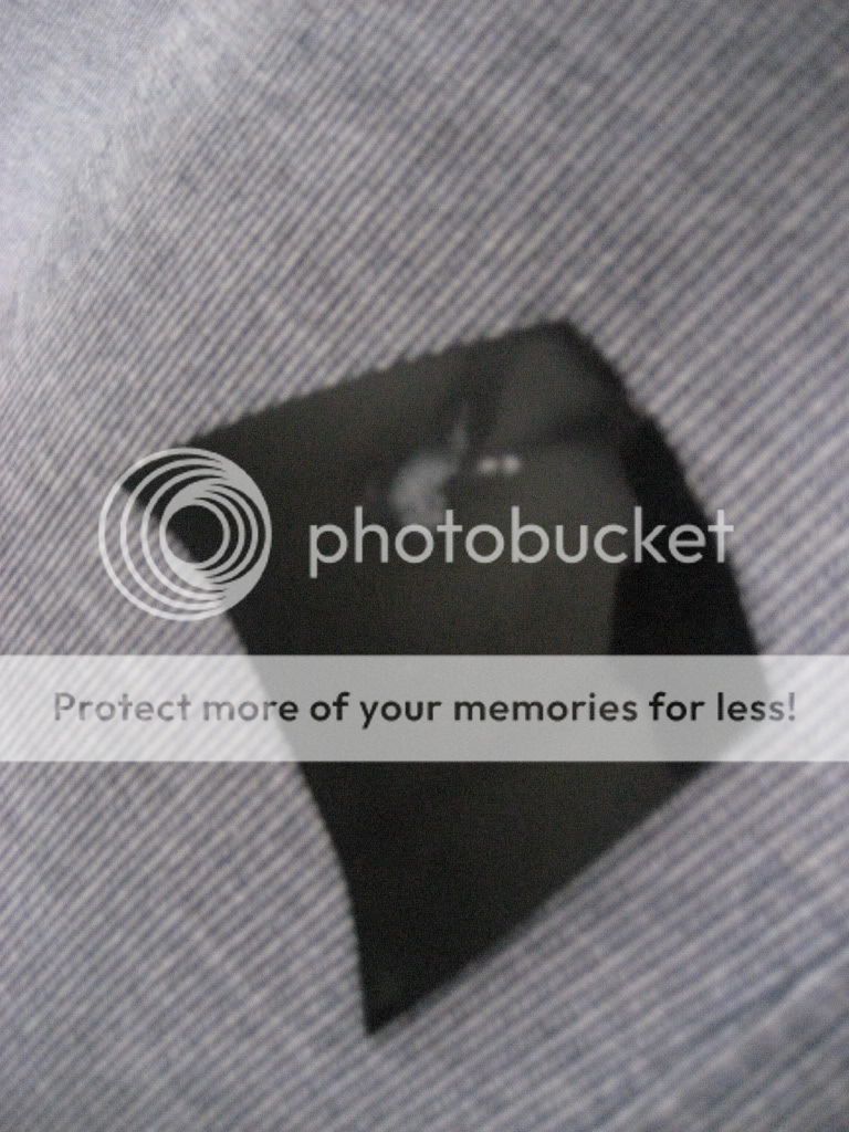

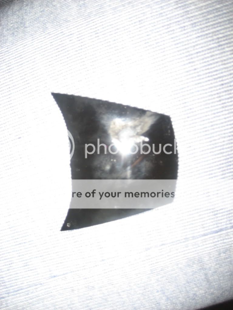

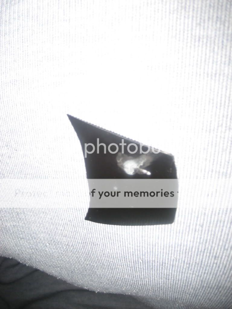

http://i476.photobucket.com/albums/rr128/ChrisJ96/Picture003.jpg
http://i476.photobucket.com/albums/rr128/ChrisJ96/Picture002.jpg
http://i476.photobucket.com/albums/rr128/ChrisJ96/Picture001.jpg

is that on top of paint or clear coat? If clear what kind? we need some details.
MBZProjext09
07-21-2009, 05:29 PM
Plastic Corvette C6 Hood
Testors Gloss Black 3 layers
No clear coat
Instant Krazy Glue Got on it
white97ex
07-21-2009, 06:20 PM
sanding is the only option I see here. I would start with some 600 grit paper. focus as intently as you can on the "glob" of clue, work it down, once it is flat, see if you can work the haze out of it. Whether you get the haze out of it or not, get the surface smooth, work up to 1500 or 2000 paper then re-spray. then clear, should be good to go
