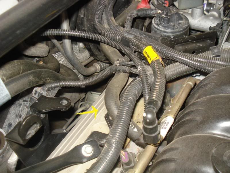

Thank you- but is there a way you can put a picture on here. Being new to this kind of stuff I am lost.
The vacuum line Lynn is referring to goes from the back of the UIM Plenum to the power brake booster. See pic and yellow arrow. If that is good then you may have a ruptured diaphragm in the power brake booster.
http://i5.photobucket.com/albums/y186/lizzywiz/DSC06829.jpg
