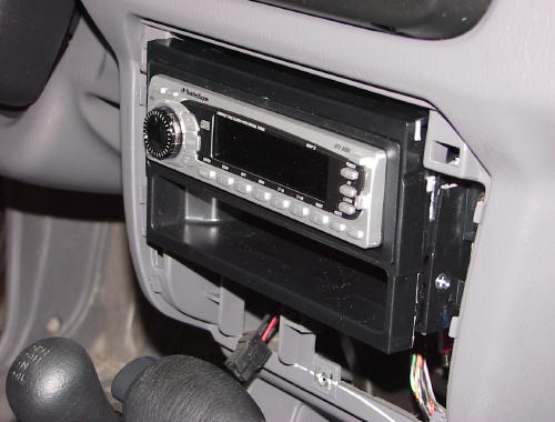

I saw a thread last week asking how to hook up a stereo. I was not impressed at all with some of the responses. The only one I did agree with was, someone said to soldier and heat shrink the connections.
I saw wire nuts and tape! not good connections for automotive use.

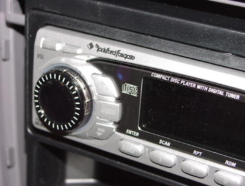

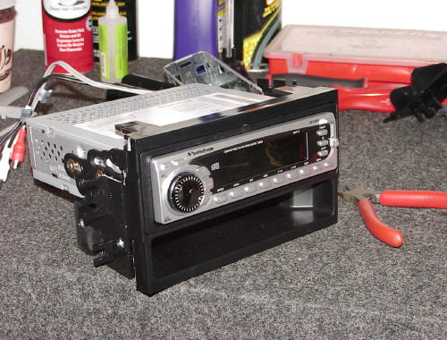

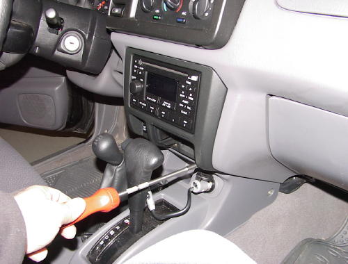

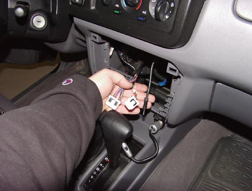

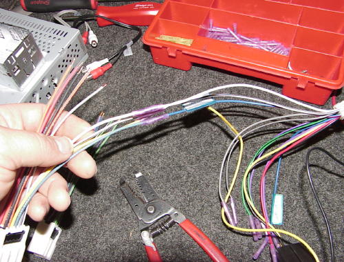

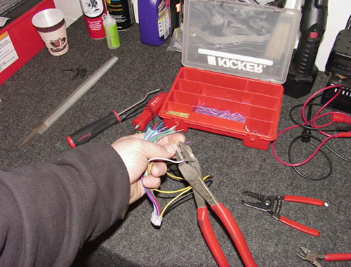

Here is a Rockford Fosgate stereo I installed into a 2000 Nissan Xterra.
This is what you should be doing when hooking up a stereo.
http://files.automotiveforums.com/uploads/252911xterra01.JPG
http://files.automotiveforums.com/uploads/141532xterra02.JPG
http://files.automotiveforums.com/uploads/982263xterra03.JPG
http://files.automotiveforums.com/uploads/968713xterra04.JPG
http://files.automotiveforums.com/uploads/257086xterra05.JPG
http://files.automotiveforums.com/uploads/292075xterra06.JPG
http://files.automotiveforums.com/uploads/624537xterra07.JPG
http://files.automotiveforums.com/uploads/968389xterra08.JPG
http://files.automotiveforums.com/uploads/806076xterra09.JPG
http://files.automotiveforums.com/uploads/649264xterra10.JPG
http://files.automotiveforums.com/uploads/453459xterra11.JPG
http://files.automotiveforums.com/uploads/760419xterra12.JPG
http://files.automotiveforums.com/uploads/611353xterra13.JPG
http://files.automotiveforums.com/uploads/489533xterra14.JPG
http://files.automotiveforums.com/uploads/982914xterra15.JPG
If there is any questions, let me know.

DMC12
04-01-2003, 06:42 PM
The industry standard at stereo shops is to use crimp connectors as you've illustrated. They work decently and should last for a few years in low humidity locations.
Below crimps (in level of quality) would be wire nuts & tape. They can fall off and cause your system to short & die (or cause a fire).
The top of the line "bulletproof" method would be soldering & using heat-shrink tubing or brush-on electrical tape.
Im my own vehicles I will twist wires together & use tape until I know the setup is something I'll be happy with (won't have to return the deck or alarm the next day). Then I go back & solder all the connections when I can find the time:D

tehferret
04-01-2003, 07:31 PM
What i did is use wire nuts to make sure the connecton it correct then what i did is cripped it and but some electrical tape around the connection so that the metal part of the cimp wont touch any other metal to short out the circuit and blow a fuse. I like sodering and heat-shrink tubing but i had my system intalled by a pro cuz i was lazy and it was free and even his sodering and heat-shink tubing connections fell off. So if i were installing a deck i would use crimps and some electrical tape. Plus my dad is a electrican and he says these are better then the heat-shrink tubing and sodering. This is just my experiance wiht things. Later.
Melt
04-01-2003, 08:27 PM
I always crimp everything ... dont have any pics of my stereo installs (im on my third deck, and about to get my 4th, moms accord is gonna get the JVC) But heres a pic from me rewiring the bumper lenses.
http://www.imagestation.com/picture/sraid52/p1b204ad3f1b205a5d4869ddcf9cbc010/fc9cfd9d.jpg
and what happens if you arent more careful with the wire cutter :o
http://www.imagestation.com/picture/sraid52/pac43cb911d72c923586f54ab29027c51/fc9cfd92.jpg

civicHBsi91
04-01-2003, 08:40 PM
i did mine by soldering them good and tightly wrapping them in electrical tape, it was nice and clean when i was all done :)

04-02-2003, 06:48 PM
Well since this is a new thread, I'll ask my question again. When crimping, do you insert both wires and let them touch? Or kinda space it out on the inside of the crimp connector and just crimp the metal contacts which touch each wire?
Melt
04-02-2003, 08:23 PM
Just insert it enough that the metal contact hits it and then crimp, and then insert the other wire and do the same.
