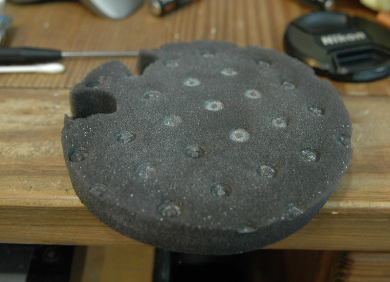

Here is the pad( Lake county black polishing pad)
http://www.viptrim.com/newer/lc1.jpg

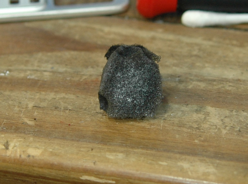

Pad that has been cut, taken off the drill for picture
http://www.viptrim.com/newer/lc2.jpg

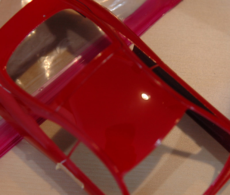

Here is the roof polished. U cant see the swirls for some reason in the pic.
http://www.viptrim.com/newer/lc4.jpg
