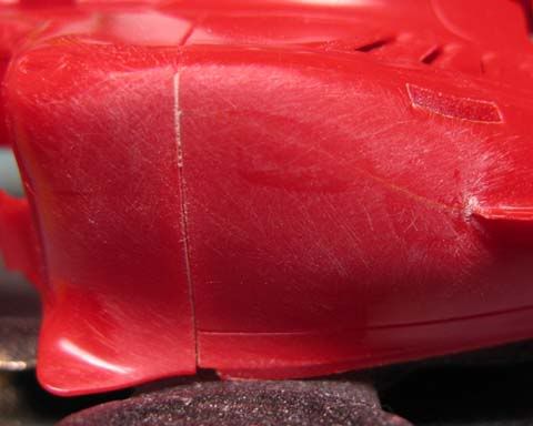

I glued parts together, waited for a few days, and sanded the surface to eliminate large gap, then I applied superglue.

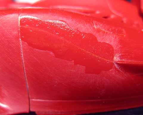

After that, I sanded the surface with a medium grit sand paper.

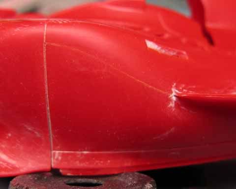

Then, I used finer sanding clothes progressively up to 3600 grit.

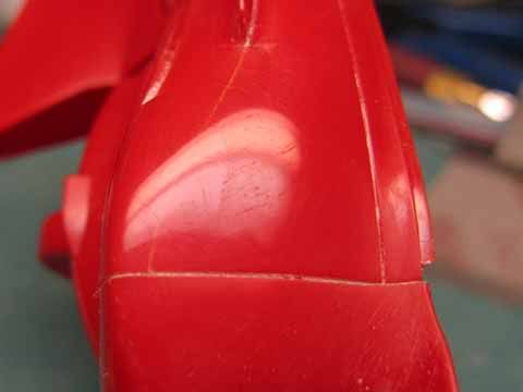

Finally, I polished the surface with Tamiya coarse compound. Now the original smoothness of plastic is restored, and the part is ready for priming. I usually apply Mr. Surfacer 1000 with a brush to fill scratches, then sand again with finer polishing cloths, like 4000-6000 grit.
http://i21.photobucket.com/albums/b258/hirofkd/248f1/IMG_1938s.jpg
Mr. Surfacer are not meant to hide "untreated" parting lines, but to fill scratches left by sanding. (Notice the words, parting line vs. scratch?) The numbers work like the grade of sand paper, where 500 being the thickest and capable of filling relatively large scratches, and the 1200 grade fills tiny hairline scratches.
For example, you can apply Mr. Surfacer between Process 2 and 3 above.
