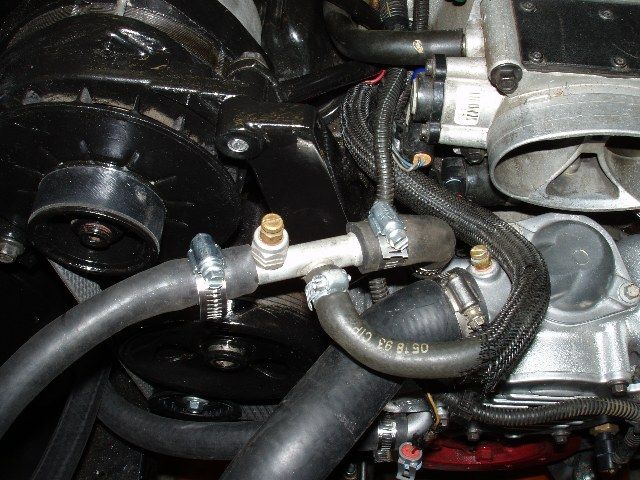

sorry i just rebuilt this hole motor every thing it is super clean inside and out the coolant steam pipe was blocked by sealent from the new water pump it was stuck at the back of the heads inside the bolts both of them had crap in them and the line to just small chunks
is this silicone sealant you are refering to...????
the water pump gaskets use a gasket sealer that is like a heavy oil...I use permatex formagasket on these...
on some vehicles you need to use a thick type sealer,,,this is where more is not better....
I replaced a radiator plastic end tank and found a big chunk blocking the coolant tube in the radiator...
using the 180 deg thermostat is recommended,,,the pcm is programed for this temp....
since you live in a warm area it is possible this would not be a factor..
where I live it has caused problems when the cold weather arrives,,,,
NO HEAT....
http://i268.photobucket.com/albums/jj20/jcat2140/LT1steampipe.jpg

IMO 160 stats are overdone but work fine, the pcm is perfectly capable of handling it too even without reprogramming. Those that think otherwise are stuck a few decades in the past.
From my EXPERIANCE a 160 stat will provide adequate heat to teens below zero.
I install the WP gaskets dry BUT you still need to use some sort of sealer on the bolts and even used sparingly I have seen this make it's way to the banjo bolts in the back of the heads. All it takes is little crumbs from the old sealer or even a small flke of gasket falling into the coolant passages while cleaning the block. The holes are quite small.
