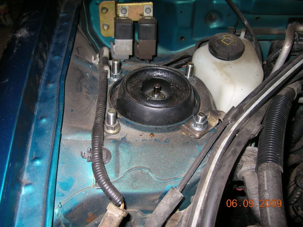

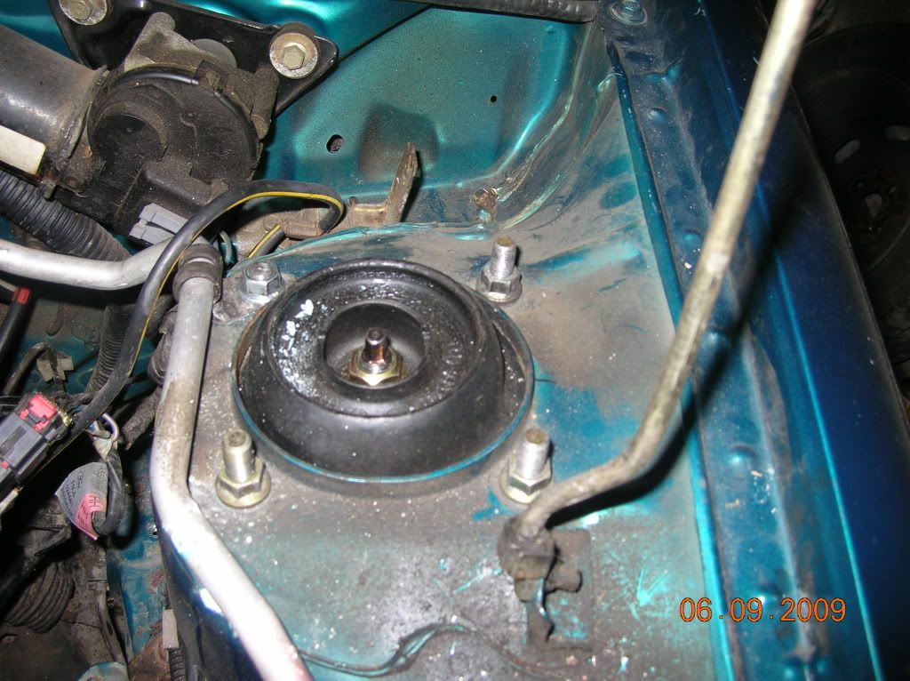

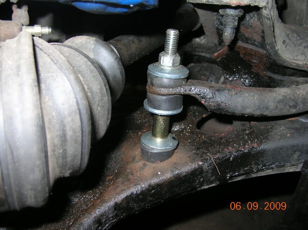

http://i687.photobucket.com/albums/vv231/badpoor71/just%20some%20car%20stuff/DSCN2866.jpgHere are some pictures i took today after I intalled two new sway link kits.

You have done a lot of good work! If you replaced the upper spring seats ... did you compare shape and size of old to new? How about the end shapes of the springs?
On one strut top (the LH side??), there looks like one stud is short ... did you shorten it?

.... also looking at that top photo, that spring needs to be rotated about a half turn to be seated properly in/on the strut-shock formed sheet metal "shelf". How did that happen?? That ain't right! I suspect that would put a real bind on the strut-rod.

I see the same thing.. looks like it needs a half turn to the right. The bottom end of the coil should settle into the indentation formed in the seat.

I see it too. It looks like the base of the spring is pointed in the wrong direction to seat. It definately is not right.

That is not the end of the spring. It is that rubber bushing/I don't really know, that comes with the new springs. The part of the spring you are referring to is located and properly seated as you mentioned.

Actually after the 6th time I took those struts apart and back together that bolt snapped while installing the top of the strut. Is this something I need to be worried about?

OK, it does look like the rubber pad now that you mention it.
I would not worry about the broken bolt ... just so you understand what happened.
Could be you now have a much stiffer set-up than you are accostomed to .... There may be nothing really "wrong".
