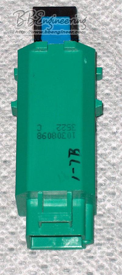

Changing it should be very simular to an impala. You have to pull the dash off - (1 screw behind the fuse panel, 2 screw above the Gauges, and 1 in the knee plate area).
On impalas, you just push in the clips, and it slides out of the front of the Dash without taking the Front button off the switch. but for the MC, you might have to pull the button off the front, and pull the switch it self out of the back.
Heres what the actual unit will ook like:
http://www.bbengineer.com/cars/impala/images/Misc/Flasher.jpg
