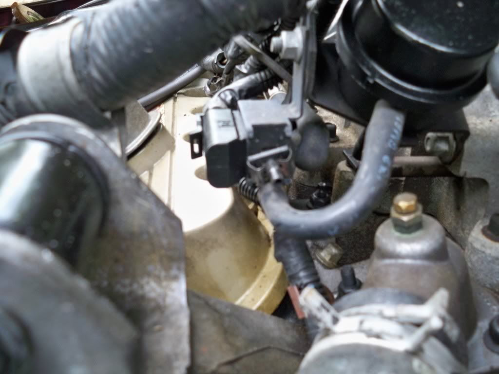

I was changing my LIM and I noticed that I had a Vacuum Hose off, does anyone know where this goes? Here is a pic.

what year is your car, and what motor (the valve cover looks like a 3800, but I'd rather be sure)?

2000 gp gtp 3800 series 2 if do you know the belt routing on that

there is no vacuum hose that goes to that spot.
All GTP's have that same deal. Except its supposed to have sort of a spongy filter type of material over the top of it. It looks like yours tore off like mine is starting to. (refir to my thread with pictures)

I wonder if you could use foam rubber on that.

ill make something for it civics have a little filter like that on map sensor and i think i might have one ive built two turbo civics the supercharger on my gp is makeing noise so i think i might turbo it
