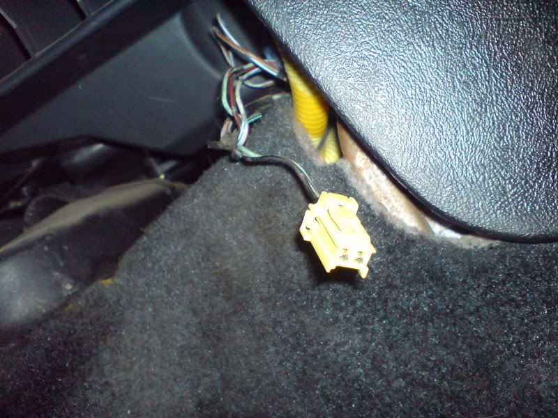

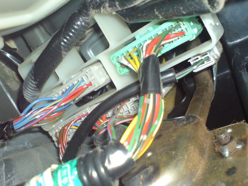

Here is what I see. I read a forum saying it's on the drivers side in Preludes. The first picture is behind the glove box, the second is the connector under the driver's side.

somick
05-19-2009, 10:46 AM
I missed your car model. Thought that was Accord.
Try to visit other Honda forums, or may be just Google...
