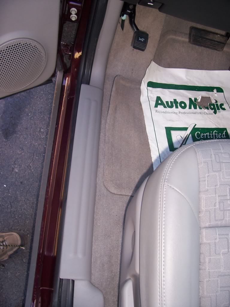

Was surfing and came across some "known problems" with GM mini-Vans. Bottom of this page contains cut / paste info.
To help eliminate, "A chronically wet driver-side carpet that can lead to a variety of electrical problems – keep the floor as dry and salt free as possible in winter", may I suggest the following (that was applied to my '09 Montana EWB van):

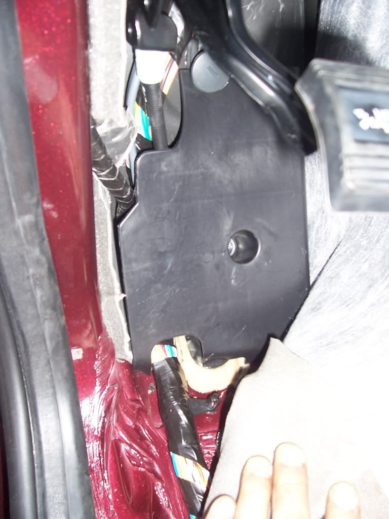

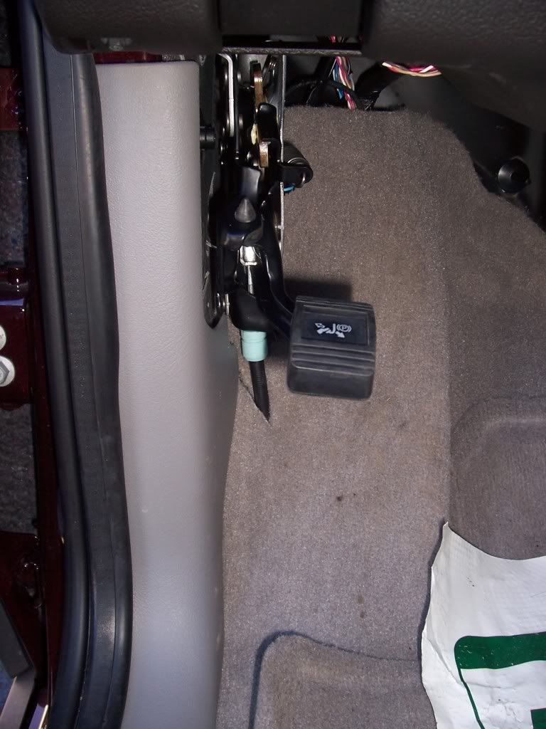

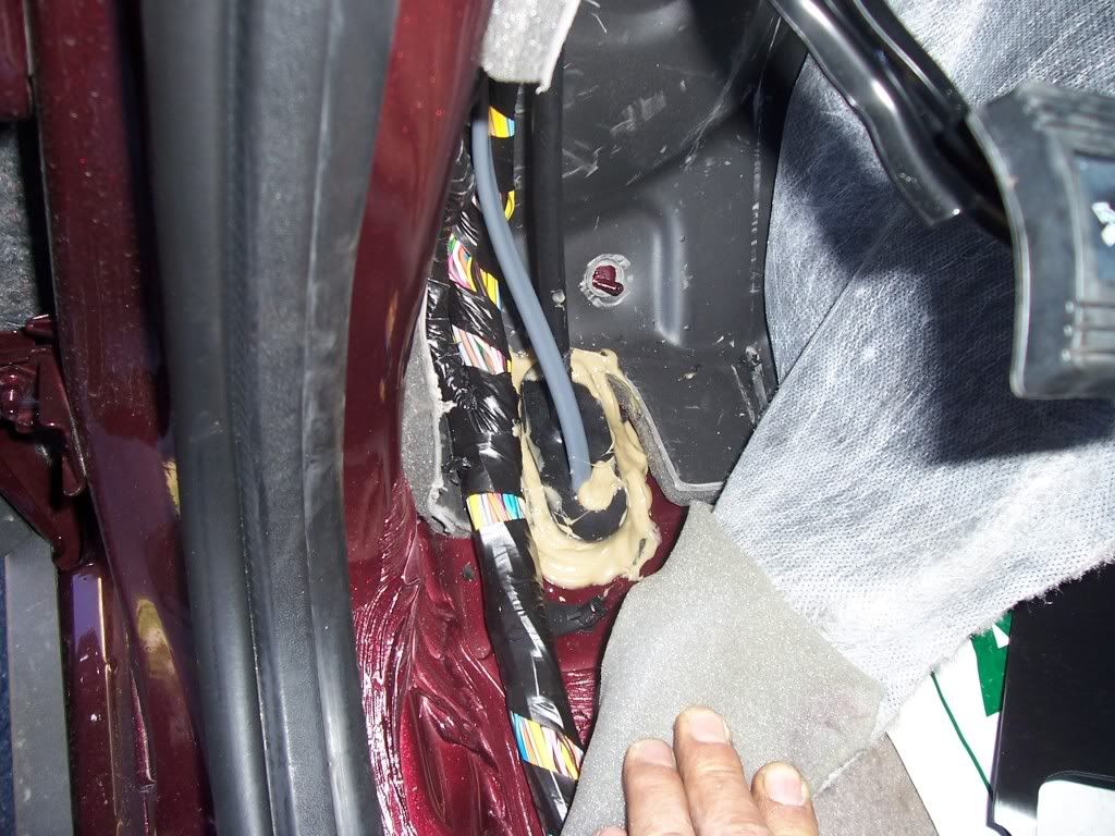

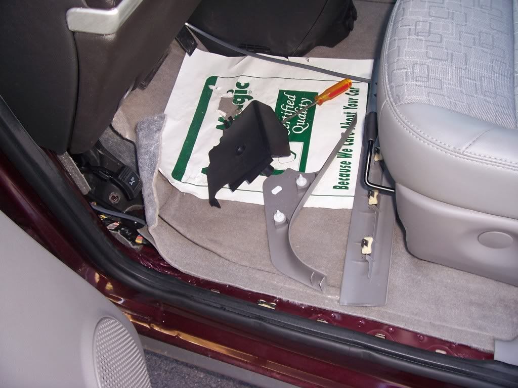

1 - Remove the driver's door plastic sill molding, remove the driver's side left foot plastic kick plate and roll-back the driver's carpet - to expose its Emergency Brake cable area. Notice that large bundle of wires in this area. re:
http://i178.photobucket.com/albums/w251/Spike99-Pictures/Montana%20Van/E-Brake-Cable-Area-9.jpg
http://i178.photobucket.com/albums/w251/Spike99-Pictures/Montana%20Van/E-Brake-Cable-Area-7.jpg
http://i178.photobucket.com/albums/w251/Spike99-Pictures/Montana%20Van/E-Brake-Cable-Area-8.jpg
http://i178.photobucket.com/albums/w251/Spike99-Pictures/Montana%20Van/E-Brake-Cable-Area-2.jpg
http://i178.photobucket.com/albums/w251/Spike99-Pictures/Montana%20Van/E-Brake-Cable-Area-6.jpg

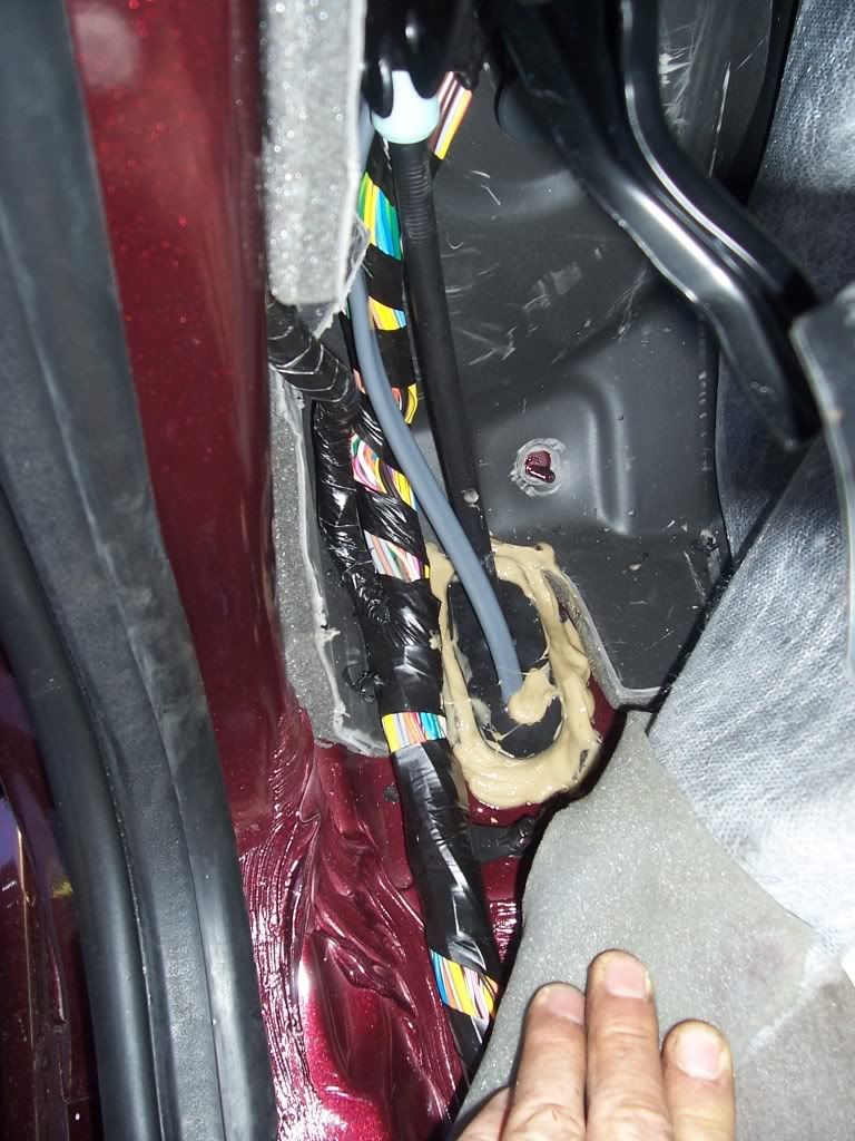

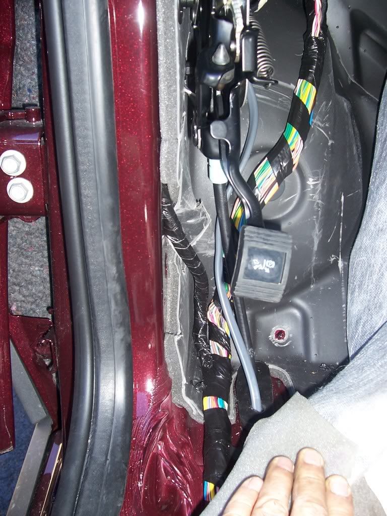

2 - Use lots of automotive tar and apply around the emergency brake cable exit hole. For my van, I used PL Premium glue around its rubber grommet instead. Thus, sealing up this area from the top. re:
http://i178.photobucket.com/albums/w251/Spike99-Pictures/Montana%20Van/E-Brake-Cable-Area-5.jpg
http://i178.photobucket.com/albums/w251/Spike99-Pictures/Montana%20Van/E-Brake-Cable-Area-4.jpg
3 - From the E-Cable's exit hole underside, I bought a can of spray foam insulation (with its long straw) and sprayed the under side of the emergency brake cable EXIT area. Thus, sealing the E-cable chassis's hole from both top and bottom of floor.
If you feel your van is getting water under its driver's side rug (where its large electrical cable bundle is), then proactively "sealing up" this area might help your van as well. Help eliminate future electrical problems.
Hope this helps other GM mini-van folks as well...
