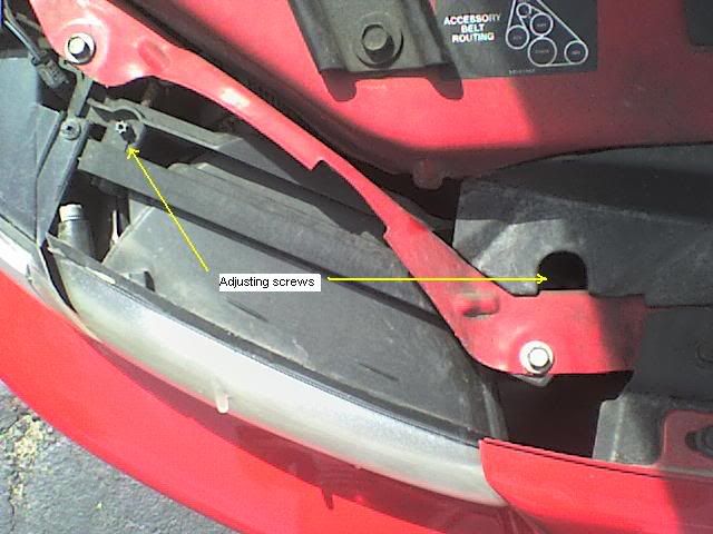

ok but how do i ajust them ? is there screws or bolts and where are they located?

There are two adjuster nuts (one for vertical, one for horizontal) on the headlamp assembly that you access from the top. I had a pic at one time, let me see if i can dig it up and I'll post if for you.

I took a picture with my cell phone. This is of the passenger side, the drivers side is basically a mirror image of this. The one adjuster screw is down in the hole on the right of the picture. My cell doesn't have a flash so you can't see it, but it's the same size as the one on the upper left.
http://i44.photobucket.com/albums/f44/richtazz/DSC00099.jpg
